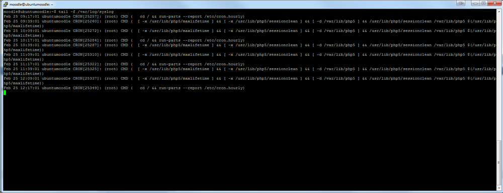

next step then it to start looking in the logs
tail -f /var/log/syslog
will show you any server type issues when you're accesing the moodle
tail -f /var/log/apache2/error.log
will show you any apache errors
