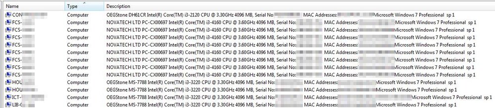

Autopopulate Computer AD Descriptions - Steds Script
Is this where the 'LDAP://RootDSE' is, just deletew that line and add IP of DC?
Sorry I am hopeless with VB :(
I wrote that bit of code so long ago I no longer know tbh its just been cut and pasted from one version to the next for maybe 4 years but I was thinking more of the csv file than ad I suspect altering that for ad will just fail
I dont understand because I can log on remotely and run the script fine.
