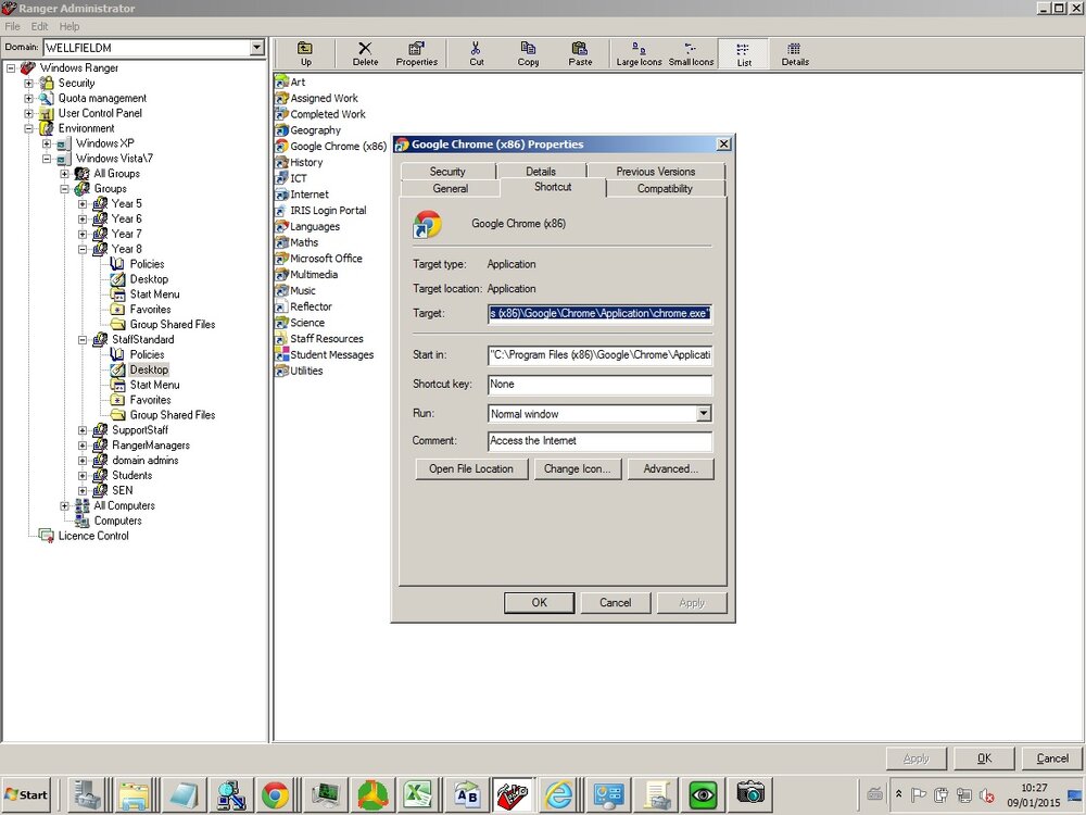

Bev Posted January 9, 2015 Report Posted January 9, 2015 We are having a big problem with Chrome not opening on certain machines. We have fixed desktops and the shortcuts are all set up using Ranger Administrator. The kids computers all use Program Files x86 shortcut, and that works fine. Most of the staff computers don't have an x86 folder, so I have created a shortcut without the x86 but whenever I paste it into Ranger to put it on their desktop the x86 appears within the link. (I don't understand how but it is definitely happening). All the computers also seem to have the default browser as x86 Chrome even though they don't have that version installed on their machine. I think this is probably related to me trying to be clever (!) and installing the enterprise version of Chrome rather than the domestic version. The end result is an absolute mess, with most staff unable to click on desktop links as they won't open, and the default Chrome icon at the bottom of the screen no longer working. Any suggestions? I'm at my wit's end and considering just uninstalling Chrome altogether, but we use Google Docs a lot and they recommend the use of Chrome. Thanks

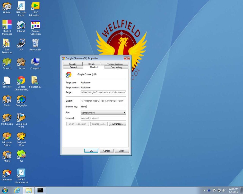

Bev Posted January 9, 2015 Author Report Posted January 9, 2015 (edited) I'm even more confused. I have a shortcut that I can see in Ranger has x86 in it, but when I get to the PC and check the shortcut the x86 has been removed. Is it Ranger that is changing my shortcuts, or is that normal in Google? Shortcut created with x86 in Program Files It appears on the Desktop without the x86 so it doesn't work. Edited January 9, 2015 by Bev
