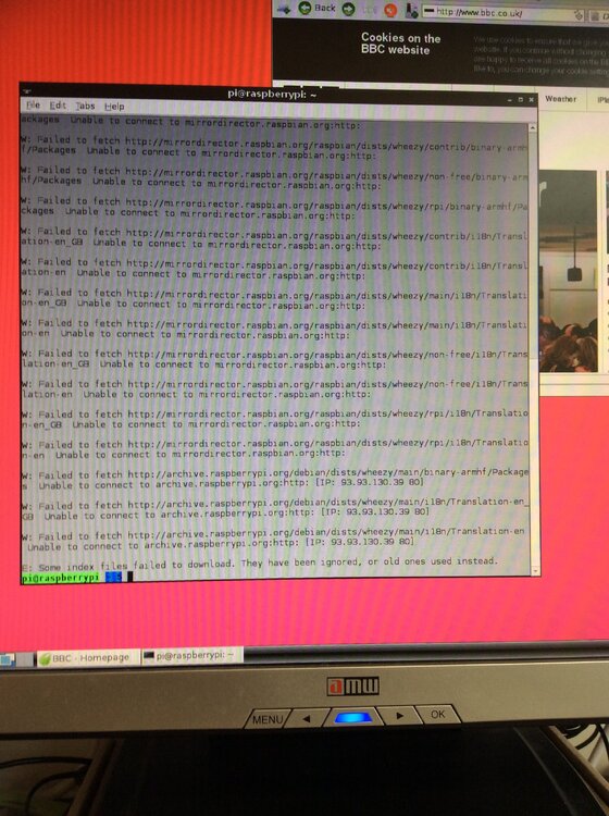

When I try this on my modules in school I can't get the updates with the errors shown on this screen snapshot:
Even if I take one of the SD cards home and put it in my own Pi it does the same. I can get to the internet thro' the Pi in school.

You need to add the proxy info for them to connect
add your proxy to /etc/apt/apt.conf if I remember correctly with :-
Acquire::http::proxy "http://user:pass@yourproxyaddress:port/";

Thanks all,
I found this on another post in the end which worked:
sudo apt-get -o Acquire::http::proxy="http://proxyurl:port" update
Edited by plexer
The only bit I can't get to work is the last bit: sudo pip install pibrella.
sudo apt-get -o Acquire::http:proxy="http://proxyurlport" update
sudo apt-get -o Acquire::http:proxy="http://proxyurlport" upgrade
sudo apt-get -o Acquire::http:proxy="http://proxyurlport" install python-pip
all work ok.
