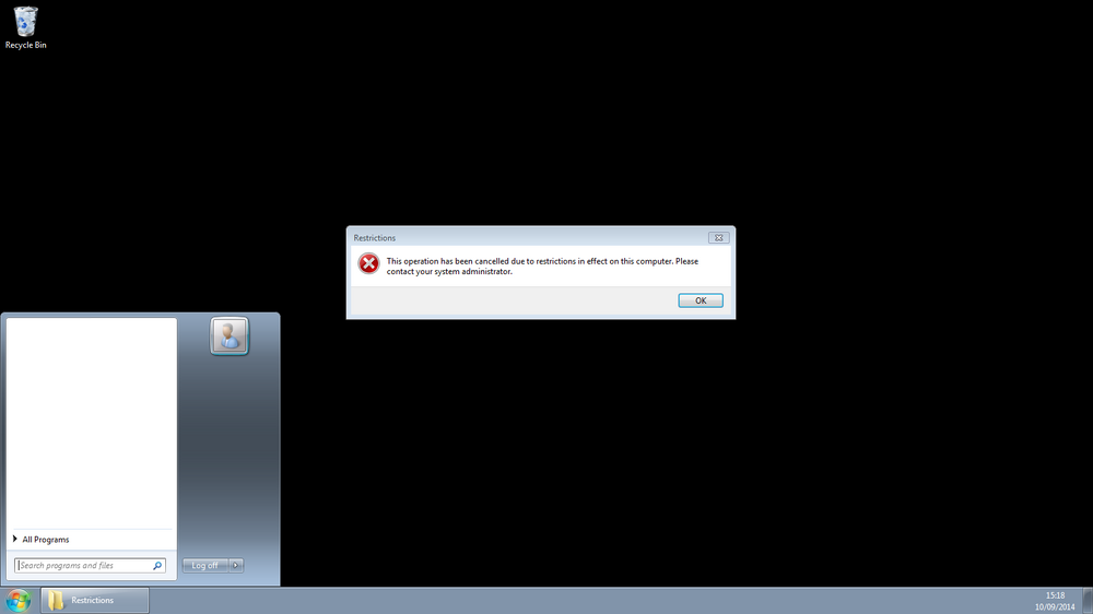

Problem is as follows. It worked fine until I scraped the entire group policy and rebuilt every machine in the school. Users can still log in to the remote gateway but now they get a start menu (where I have no idea where it comes from???) and they don't have access to documents or shares. Staff can create their own share and save it to the desktop as a short cut but that's not a proper solution.
if I click on the image icon on the start menu I get this error message - The operation has been cancelled due to restrictions in effect on this computer. Please contact your system administrator.
So this is clearly something in my users group policy that is breaking it down. I have very few GPOs actually set and they are all there for a reason. I need a way of adding the shares to the start menu or desktops.

When the user now logs into the network on a computer in the workstations OU the workstations policy is applied. I can see this when I collect the RSOP data that this policy and only this policy is applied. However if I click on the start-menu and click the image in the top right I get the same restrictions that are set on the remote desktop are also set here. (This operation has been cancelled due to restrictions in effect on this computer)
