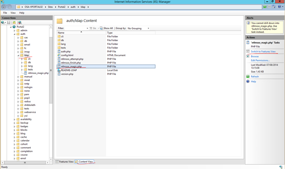

jamesfed Posted August 12, 2014 Posted August 12, 2014 Have you made sure to only enable Windows Auth on the ntlmsso_magic.php file? If you have tried to add Windows Auth to the whole site it just won't work. 1
chrisjako Posted August 12, 2014 Author Posted August 12, 2014 (edited) can't see files in IIS8 on the left side of the browser like in your picture however, I set the whole ldap folder to windows authentication and rest of the site to anonymous and its working great - thank you Is it possible to setup outlook OWA 2013 in the same manner? FBA external and SSO internal? Edited August 12, 2014 by chrisjako 1
jamesfed Posted August 12, 2014 Posted August 12, 2014 can see files in IIS8 on the left side of the browser like in your picture however, I set the whole ldap folder to windows authentication and rest of the site to anonymous and its working great - thank you Is it possible to setup outlook OWA 2013 in the same manner? FBA external and SSO internal? No problemo To get to the stage where you only see the file you need to select the folder, go to Content View, select the file then on the right hand side pane select Switch to Features View - it will show you the settings for that file only. Afraid I haven't had any experience with SSO and OWA 2013 - might be best to make a new post for that
