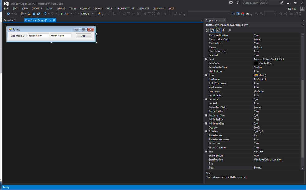

I'm attempting to make a small tool (to use on multiple sites), that basically automates the jobs we'd usually run batch files and vb scrips for at the click of a button.
Currently, I'm looking at adding the printers.

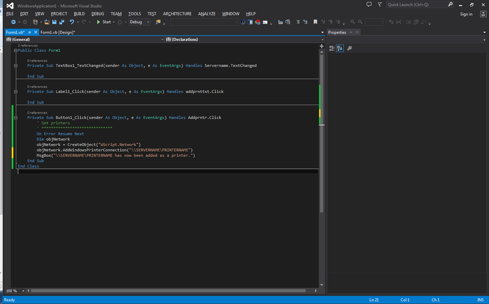

Basically, when the "Add" button is clicked in the first image, the code from "Set printers" in the second image is run, but I want "SERVERNAME" and "PRINTERNAME" to be replaced by what is typed by the user in the retrospective text fields above.
Is this possible, and if so how? I image its just a "ValueOfTextbox1\ValueOfTextbox2" type thing?

Sorry to elaborate:
In this case I would do the following...
Dim SERVERNAME as string = me.textbox1.text
Dim PRINTERNAME as string = me.textbox2.text
objNetwork.AddWindowsPrinterConnection("\\" & SERVERNAME & "\" & PRINTERNAME & ")
HTH

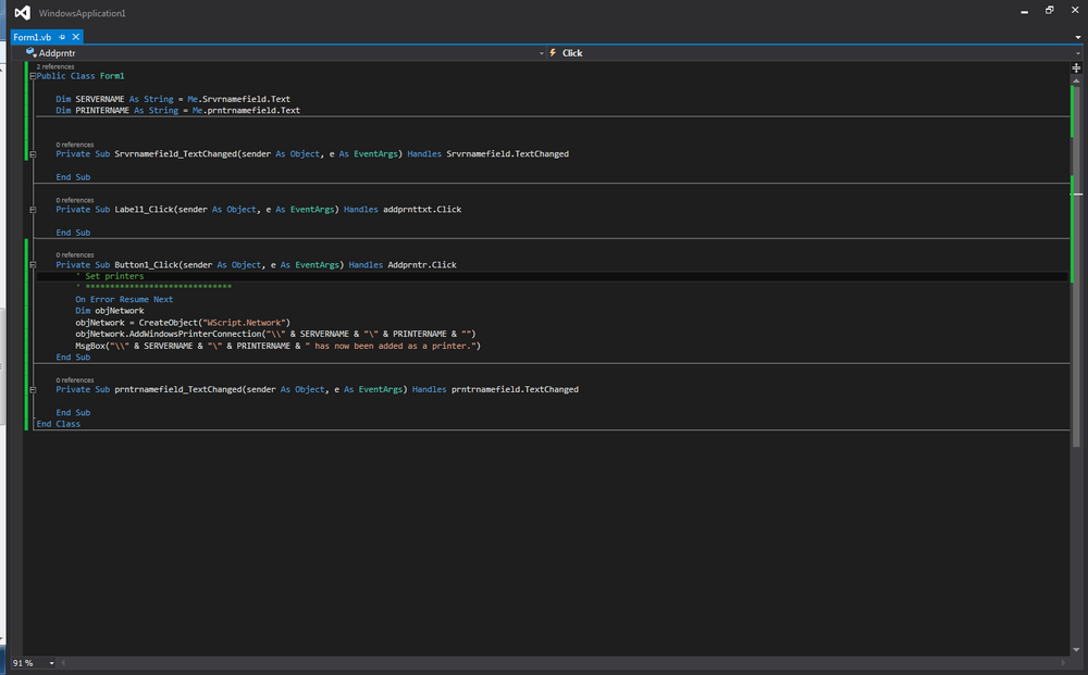

Thanks! - I should have thought of that, I've done that recently but still quite new to it...
I'm now getting this error, but can't seem to find an issue with my code. Nothing is showing in the "Error List" - I've read the linked articles but can't seem to relate the issues to my project.
Any ideas?
Move the DIMs in to the button click event code :)
Beat me to it, at the moment it is populating those variables with nothing as it runs when the form is created and the user has not yet entered anything in so the value is null. By putting it in the onClick handler it only runs when the user has (hopefully) added the required information.
Only because i was too lazy to explain why :)
Hopefully that will sort you out @gtg93
That's done the job, thanks... I thought setting it at the top would make it available to the whole code for the remove and default option I'm also going to add.
