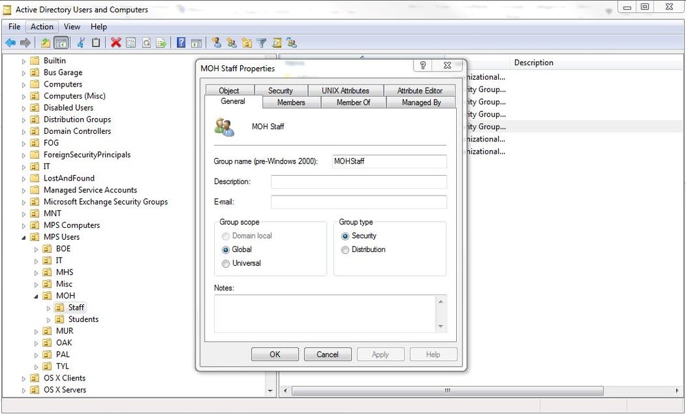

nickbro Posted March 31, 2014 Report Posted March 31, 2014 Ok. that sounds like a AD issue with the role provider, can you have a look at ~/bookingsystem/web.config and check they are AD groups, not AD OUs
nsavoie Posted March 31, 2014 Author Report Posted March 31, 2014 MOH Staff is a group. I included a screen shot.
nickbro Posted March 31, 2014 Report Posted March 31, 2014 ok, can I see a copy of the web.config from the bookingsystem folder please?
nsavoie Posted March 31, 2014 Author Report Posted March 31, 2014 Here is the file. I cut and pasted it.
nickbro Posted March 31, 2014 Report Posted March 31, 2014 Can you remove the space between MOH and Staff, as it uses Server 2000 naming 1
nsavoie Posted March 31, 2014 Author Report Posted March 31, 2014 I have tried that before. I have the booking system running in another instance and is not using the server 2000 names. Anyway, just made the change in web.config file and then in the resources to show o "MOHStaf". Tested it out and it is working! Strange, but it is working! Thank you so much for your help!
