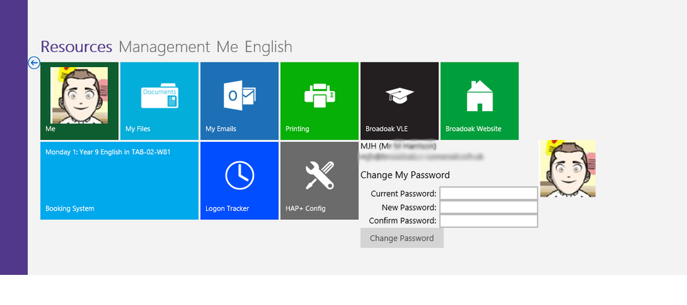

Hi All, when I setup HAP without changing the homepage links,ie only Resources, Management and Me are shown it works as expected. As soon as I add another group (in Home Access Plus+ Setup > homepage > Links Add Group) it breaks the homepage.
I have attached the two pages for comparison.
Can anyone suggest how to fix this issue?

Try moving the English group above the Me tab group, see what happens, apart from that I know there's a few fixes in v10 that fix some things with adding homepage links

Looks like the xml is incorrectly created when creating new homepage groups. For example creating a new group called "Maths" results in this being slipped into the hapconfig.xml
When it should be
Remember to add a link otherwise it borks too

Thanks. Yep, you need a link in the group for it to work properly
Hey @nickbro
Just to confirm not having a link in the group wasn't the actual problem we were having. It was the xml tag not being closed properly by the code.
Cheers
The tag was closed properly, /> is a self closed tag. v10 has some fixes for the homepage where adding links was actually throwing an error message
My favourite saying, "every day is a school day", didn't know you can close tags like that. Still doesn't work with that method though but happy to manually fix when we add a group
