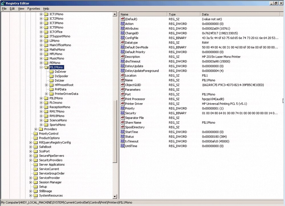

Ta Sparkeh. They're not there under HKEY_LOCAL_MACHINE\SYSTEM\CurrentControlSet\Control\Print\Printers anymore. Just the ones I've got left that previously were no trouble and a couple that aren't named/appearing under Print Management with "CSR|" infront of them.
