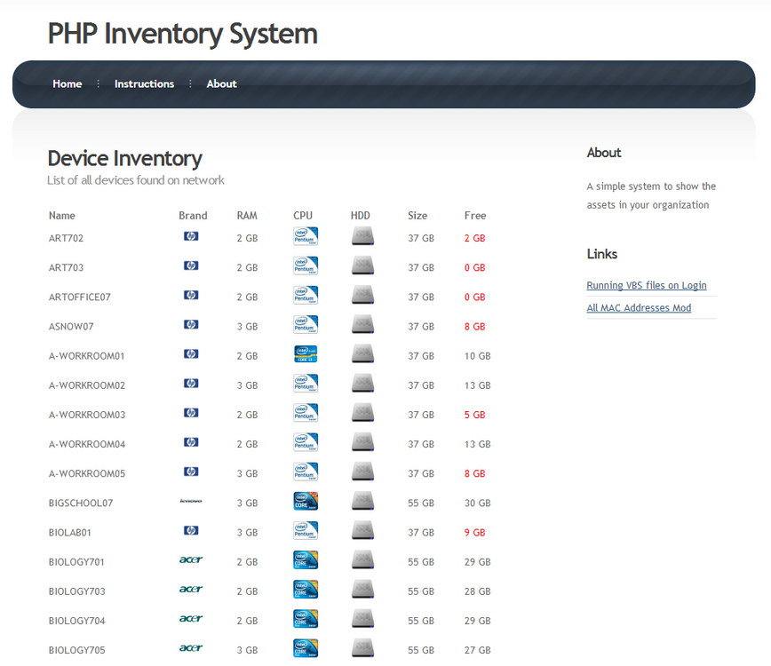

zag Posted October 17, 2013 Report Posted October 17, 2013 Thanks to FN-GM for the initial VBS script from this thread This PHP web frontend just shows a list of all the computers on your network with icons and stuff. Features - Shows Computer Name - Shows Computer Manufacturer Brand Logo - Shows RAM/HDD/CPU - Shows red warning when hard disk under 10gb - Shows CPU icon - Shows SSD or HDD icon Instructions If you have a CSV already created from the above vbs script, just copy it to the /CSV folder to see it working. Otherwise read the instructions in the readme file. Source GitHub Screenshots 2
sted Posted October 17, 2013 Report Posted October 17, 2013 oooh ive been meaning to look into that for my own similar script would it be possible to alter it myself or would you be willing to have a look (again mine pulls to csv but i suspect in different orders and quite possibly different info (it also writes to the description field in ad))
zag Posted October 17, 2013 Author Report Posted October 17, 2013 Yeh its all configurable, there is a settings.php file you can choose a few basic options. Otherwise just change the $data variable to the field you want to see. I'll make an extra page for networking data such as MAC + IP soon. Then maybe an asset page which will show the Serial number and model. 1

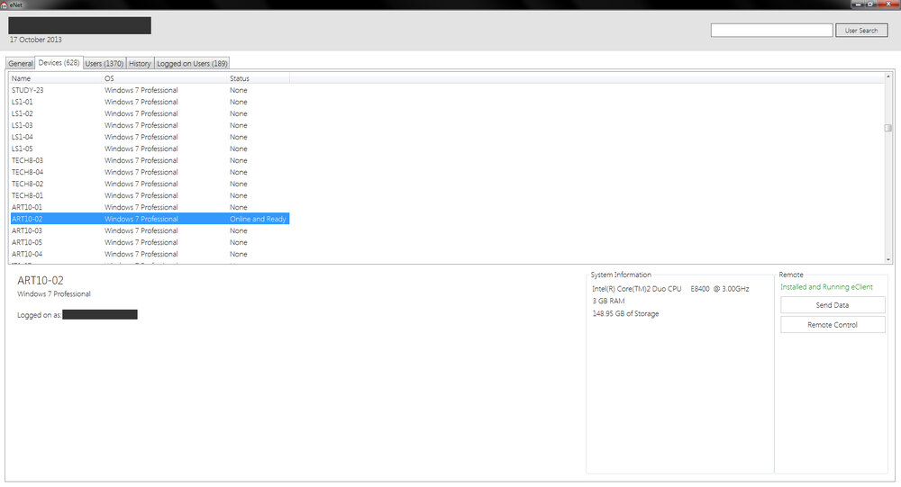

SovietRussia Posted October 17, 2013 Report Posted October 17, 2013 I built a whole suite of PC and Network Management tools, the Devices tab runs through AD and grabs the devices, then uses WMI to update them, also pings them to check servers are online etc.
zag Posted October 17, 2013 Author Report Posted October 17, 2013 That looks cool @SovietRussia but I prefer web stuff myself. I've just commited some changes to add an Assets page and a Network page. No more searching for MAC addresses yey!
