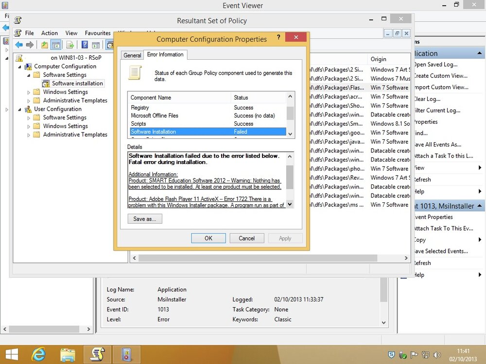

sted Posted October 2, 2013 Posted October 2, 2013 now granted im installing it to 8.1 as im doing some testing and development to see how fit or not this is but manually it works via gpo I get the mst file is the same as I use in the batch file on this pc so it should work. Anyone seen the error before and got any ideas google just mentions language packs ive installed uk and that's it p.s. I know about flash but im trying to keep it using the same policies as win7 and next time I update flash I will move that from a generic policy to a flash only one and not run it on win8
sted Posted October 2, 2013 Author Posted October 2, 2013 I stand corrected dosent work manually I could swear it did last week
sted Posted October 2, 2013 Author Posted October 2, 2013 in case this affects anyone else looks like it was due to deploying an earlier version that didn't work on 8.1 just hung so removed policy and rebooted pcs so it was partially installed and when the new version tried to install it couldn't remove the old one and failed quick reg hack later and job done
