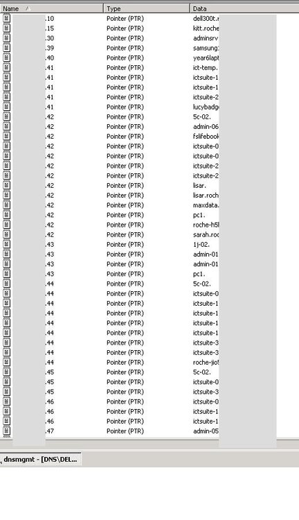

Hi all,
Whilst looking through a SOLUS 3 issue I've come across a a potential DNS issue. Looking through my A and PTR records I have lots of records for the same IP address. Lots of these records are for machines that we do not have anymore so I'm a little baffled as I'm sure when I set the network up DNS and DHCP were linked. Any ideas on how this can be resolved would be greatfully received, I'm not great with DNS so as dumbed down as possible...DNS issue.jpg
Looks like the scavenging is enabled on records but not on the zone or the server (See pics). I'm going to follow the instructions in the 'Don't be afraid of DNS scavenging' document, is there anything else I should be wary of? I'll do a system state backup before I start but I'm worried I'm going to remove records for our DC (Also the DHCP and DNS server).DNS issue 1.jpgDNS issue 2.jpgDNS Zone.jpg
