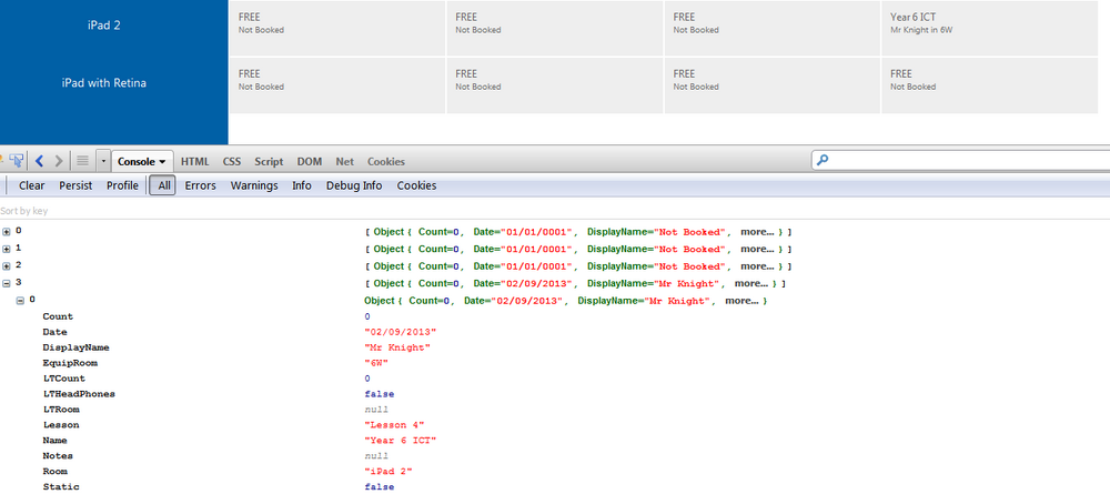

Paul-K Posted August 31, 2013 Author Posted August 31, 2013 Hi Nick, It doesn't appear to be sending the count in the post request as shown below:
nickbro Posted August 31, 2013 Posted August 31, 2013 That's not the request, that's the response, I need to know what's getting sent not want comes back
