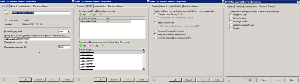

do you have anonymous connections set for incommin smtp, cant remember where it is off hand.
Rob
Hi Rob, Yes we do - we have an internal servers rule with annoymous authentication for the IP range of all of our servers. Thanks
But did you set the extended rights?
Sorry where can I set these? I tried to set up a new connector using the powershell command but when I type in all of the commands from the site that you have listed I just get a prompt of >>
Thanks, Ed
If you have a look at that link I posted, it's all there. Let me knkw ehich part youvget stuck on. 1st create the connector via the EMC, then set the permission via EMS.
Have you created a dedicated connector for relaying?
Hi Sukh, Yes I had a decicated connector set up for relaying. I've just deleted it and started over following the link step by step which is now working. Thanks so much! :D
