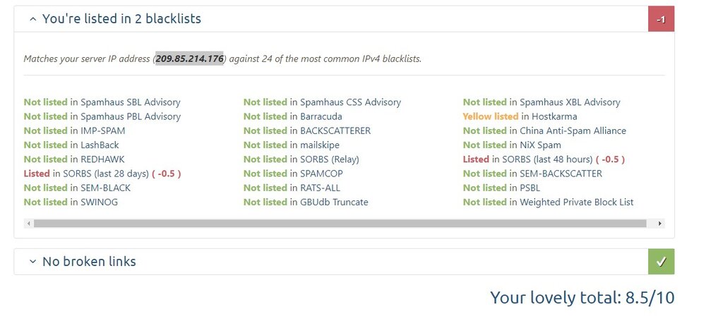

  1. Hi Noohad, Nope, this is still an on-going issue after all the investigation I've done the originating mail server IP's are Google's and they are on blacklists. This was the last response from Google Support: As of yesterday they have now requested another phone call for an update which I am currently in the process of scheduling. However based on the fact they have not responded with a solution I expect the phone call is to inform me they are still looking into it.... Have you created a support ticket with Google yet?
  2. Google support did do a header test from an email and said all looked good. However I did run that Mail Tester you linked and it came back with this: Which is interesting as its the first one that has shown a google mail server on a black list.
  3. Forgot to add, yes we do have an SPF record in place as well.
  4. We started getting reports from about a month ago of parents not receiving emails from the school. We then also got reports of the same from our HR dept trying to contact potential candidates via email not getting responses. In both instances we asked them to check their spam and the email's were there. Initially we thought the issue was only affecting external Gmail inboxes but some who have Hotmail addresses have also reported the issue as well. We ran a test with my colleagues personal gmail account and it did go straight to spam but prior to a month or so ago this was not the case. If he then marked any email that we sent as part of the tests as "not spam" the mails would then start going straight to inbox as expected. What we cannot figure out is what changed to make certain inboxes start marking emails from our domain as spam? We have tried all manner of variations (with / without subject, titles, signatures). What is odd is this did not affect emails going to my personal gmail or hotmail accounts and does no seem to be wide spread, but enough that is causing issues. I have raised a ticket with Google and after a back and forth suggested we change our eternal facing IP as it maybe blacklisted. However I have checked our external facing IP's and our domain name with MXtoolbox and others all come back with none being blacklisted. They said that it's going to be something the recipient will need to resolve. Which does not help us as if we are emailing someone we have not emailed before and the email happens to be marked as spam we then have to go through calling them and asking them to check their spam, not the ideal scenario. What we do know is a handful of parents who were getting emails from school in the past to their inbox, now goes to spam until they go into their spam folder and mark any emails from over a month ago from our domain as not spam. We have sent out an SMS message to all parents to check their spam to at least make sure it's working for them. However as it stands this issue does still seem to be affecting random external gmail and hotmail inboxes that we may or may not have emailed before. We have not got reports of other services yet, but this could just mean they are not informing me. I have also setup the Google postmaster tools but is currently still blank (it's only been running for over a week, so I assume I will need to wait longer). I can confirm we have SPF, DKIM and DMARC in place (policy currently set to pass, Quarantine/Reject policy not enabled). Does anyone have any ideas?
