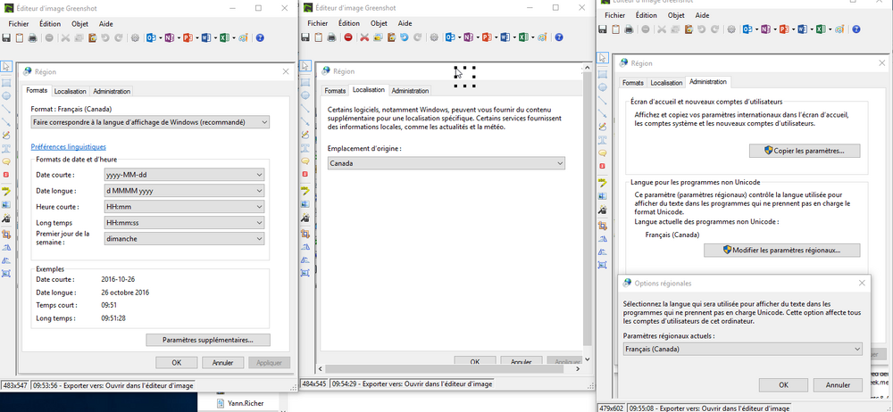

  21. My region settings are set to "Français (Canada)" under the Formats tab and Canada under the Localisation tab and "Français (Canada)" under regional settings in the administration tab. (Win 10) Where else should I set regional settings? When I delete the file, it gets recreated and A4 is the default paper format.
