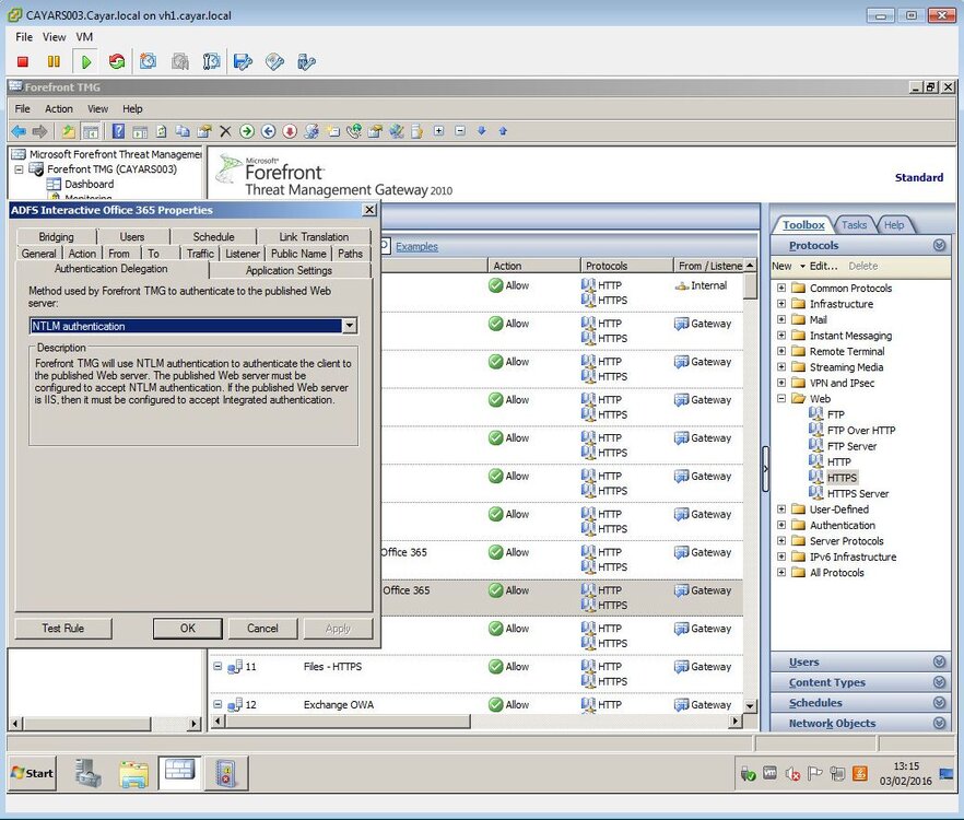

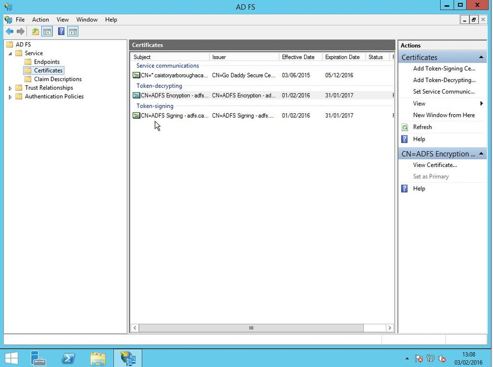

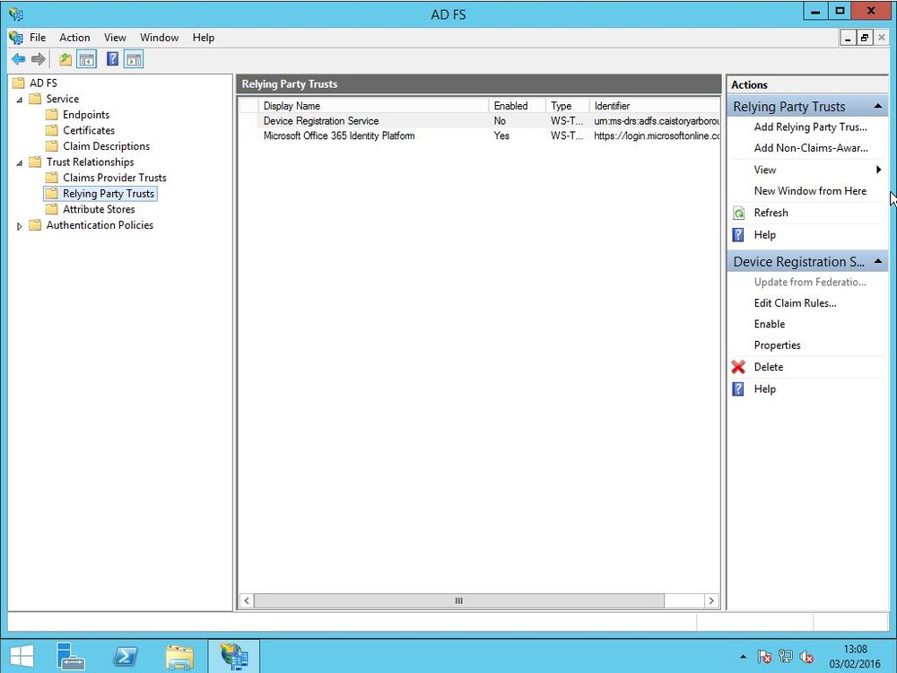

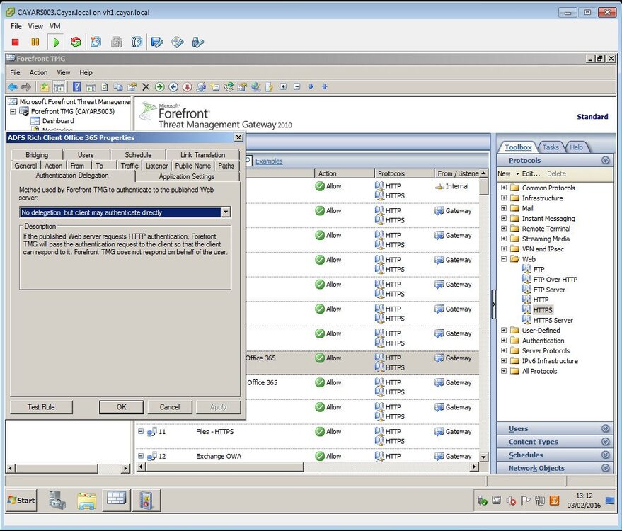

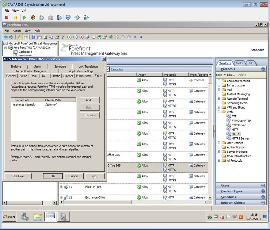

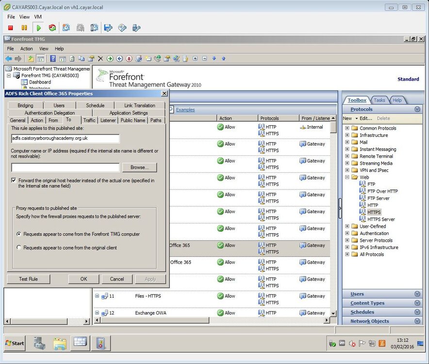

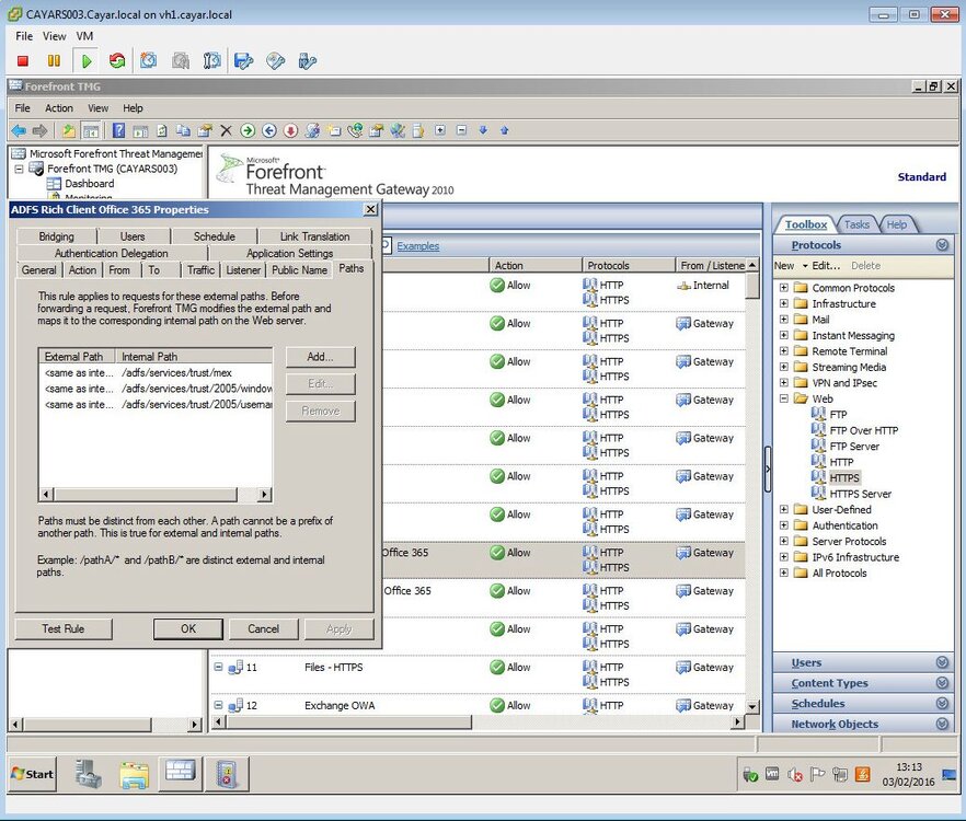

  6. I have followed what you said but now all I get is an authenticated box. Even added to trusted sites etc. I have attached screenshots of my TMG config as well as ADFS. I hope this helps..

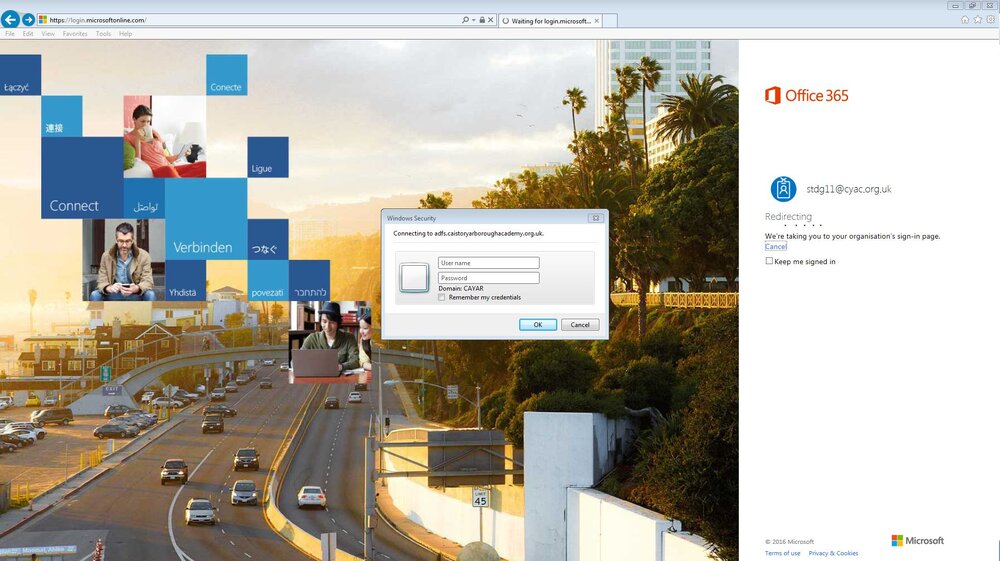

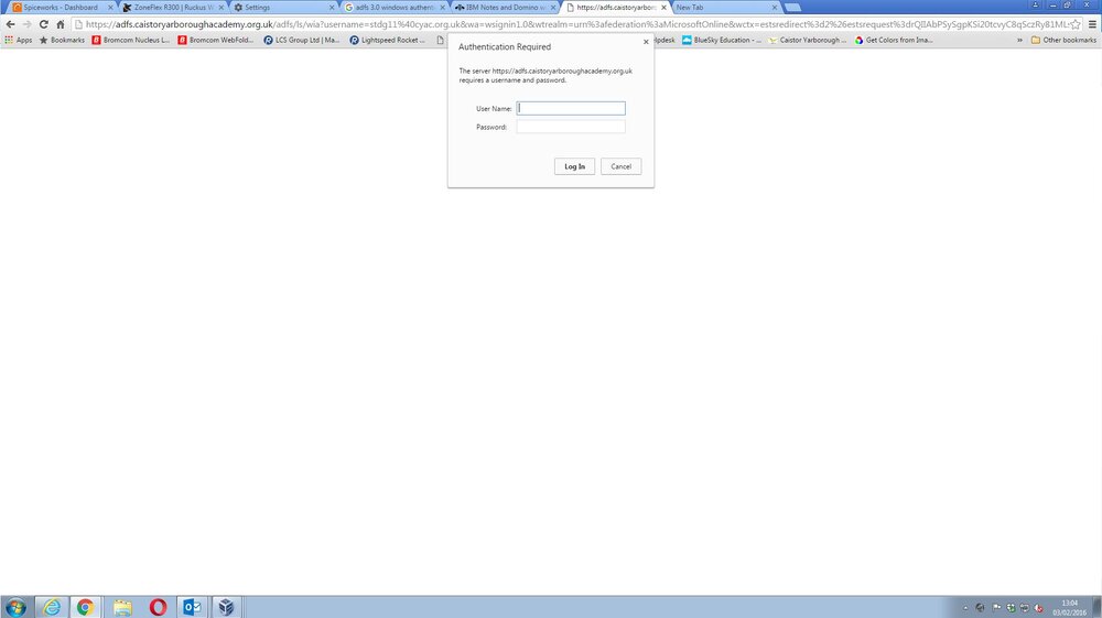

  7. So everything is set up on here now I have covered everything I think. I can get logged into this page manually absolutely fine by typing in the password. I just don't know what to look for for it to not require a password to sign on and just go straight through when I log onto my desktop in the morning. Done all IE checks moved ADFS onto a member server set up TMG to pass through and it does. I just am resigning to the dreadful line now of "I don't know".

  11. It was all done before I started working here. It's not something I tend to touch I have tested using IE 11, Google Chrome (I have tested removing the extendedtokenchcheck) Found the PS on TechNet but it didn't make a different. I also tested Opera and have tested on Microsoft Edge. It doesn't seem to like any of them.

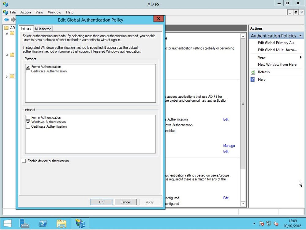

  12. We have Site to Zone Assignment List set up through our Default Domain Policy GPO and I have added the URL in there. I have also made sure in Advanced IE Options. Windows integrated authentication is enabled. Although our ADFS is set up for just using Forms Authentication. I have tested outside the office also still the same symptoms. I am just looking at it thinking what have I missed... So far Steps I have follows are Set up DirSync Used IDFix to fix any broken UPN Suffixes so all User Accounts are updated. Set up ADFS Role using Wild Card SSL Certificate. Configured a WID Set up service account etc. Add an A Record in DNS to point to the Server ADFS is hosted on. Made sure in our DNS Panel externally an A Record is pointing to our External IP with the FQDN tag. Set up the domains to be federated. Synced all user accounts to Azure AD. Made sure the page comes up. Have done remote connectivity test using https://testconnectivity.microsoft.com/ Made primary authentication for both internal and external to be forms authentication. Made sure all UPN Suffixes are passed through. Rebooted the server. Gone to Login.microsoftonline.com typed in the UPN suffix to which it redirected to our ADFS Page. The page shows up fine but just asks for a password. I have also gone to the IDPinitiated Sign on and that asks for a password too. It signs in fine manually and signs out fine. Thanks I appreciate your help with this.

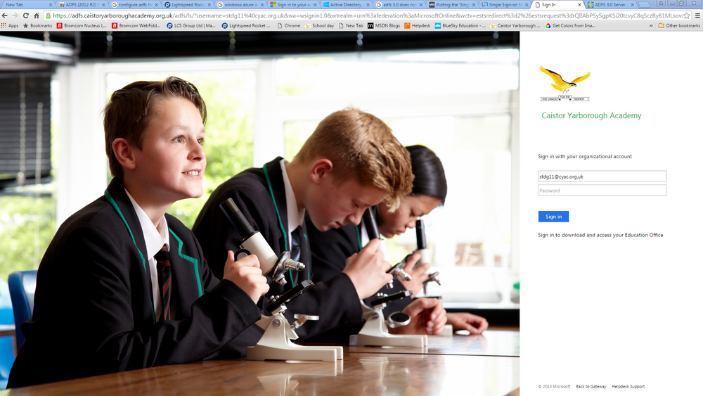

  14. Good Afternoon, I have set up ADFS 3.0 on our DC running Windows Server 2012 R2. I have Dirsynced all our accounts to Office 365 configured Single Sign On. I can Redirect to our ADFS logon page However when you redirect the ADFS Logon Page it is asking still for a password. I have AD synced to Azure also and according to both domains they are federated for Single Sign On. I have assigned a Wildcard Certificate and made sure the domain exists everywhere. I also have The Token Certificates configured as per what ADFS makes when it is set up. As far as I can see it should all work however I still can't get it to just bypass the logon and go straight into office 365. It does login manually absolutely fine using the UPN Suffix. I have made sure all accounts have been updated to the UPN Suffix I wish to use. I have also got TMG 2010 Configured as our Web Application Proxy and when you do a test using the test connectivity page on Microsoft it all passes. I am just not sure what I could be missing to cause it not to logon automatically. Any help would be really appreciated. Thank you, Damien
