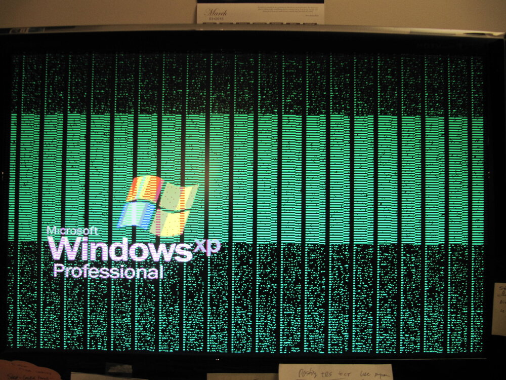

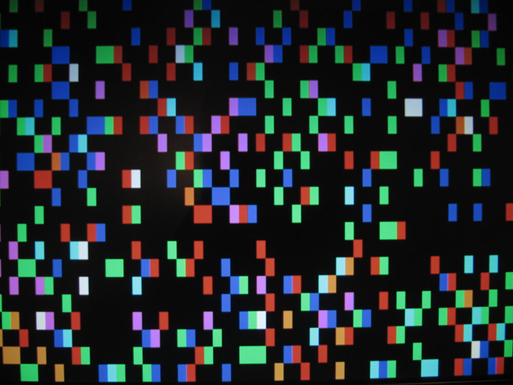

  15. OK thanks for the tip to contact Dave. I sent him a PM. Is this the correct way to contact him? Finally found out how to get photos from the camera to here. One of the problems is my screen is about 40% of the content, and usually I cannot get the other 60%. This means I often cannot even get to a program. I'll try to post these two. First one is self-explanatory. Second one is of the screen at startup. Bet no one could tell this. But I like it as a photo, kind of modern art.
  16. To add to what I wrote before, The display problem starts with the machine startup, meaning it can't be a heat issue. The first image on screen is garbled. As for the thermal paste, that goes beyond my limited knowledge. It's looking like what 3s-gtech wrote as the real problem. Is there any other way to check that it is the solder issue? One more note: In searching for solutions to the problem, one result was from the nvidea website: "The Code 10 error is most often a result of not having the option "Assign IRQ to VGA" enabled in your motherboards system BIOS." If this seems a reasonable cause of my problems, how do I ascertain if I need to assign the IRQ to Vga?
  17. I have a camera and took a photo of the screen but could not manipulate it to my laptop properly because of the problem of photos displaying improperly. Every photo is garbled. Oh well, you'll have to trust me that the screen display is very hard to work with. I ran add/remove hardware to uninstall and reinstall the Nvidia. To begin with, I cannot open NVIDEA nView Desktop Manager. The first time I ran the add/remove hardware the result was something like: "cannot uninstall this program because it is required for operation of this computer" (an uninstaller that's programmed not to uninstall? It was the Nvidea uninstaller). So I tried a second time and then it seemed to work, but got the message from the Found new hardware wizard: "cannot start this hardware. There was a problem installing this hardware. NVIDEA Quadro NVS 140M. This device cannot start." Re the suggestion to use canned air etc., I did that a few months ago.
  18. OK thanks for the info. I'll try the uninstall reinstall. I just noticed on another PC that my screenshot of the display problem in my first post above displays correctly. How can I get a screenshot of how my screen actually looks like?

  20. My old Lenovo T61 (8892) has recently started shutting down without warning: first the mouse freezes, then the screen freezes, then the screen goes black, and I hear a click sound from it, and it shuts down. All this takes about 30 seconds. When I restart the system I usually get a weird looking screen directly at startup.The colours are all wrong, there are all kinds of lines, and the screen display shows a fraction of the normal screen; by this I mean that the screen is still the size of the monitor, but only about 1/3 of the content is shown because the characters etc. are larger. I tried to get a screenshot and I'll try posting it here. I tried to use the display troubleshooter, didn't seem to be useful. But I got the message that i should update and/or reinstall the display adapter driver. But I'm working in safe mode to avoid the problems I mentioned above.and the display properties are not available in this mode. Another message was to update the motherboard, and I know there is an update for it, but I'm reluctant to take such a big step, having read reports of new problems caused by doing that. Thanks for any help. Sigh...
