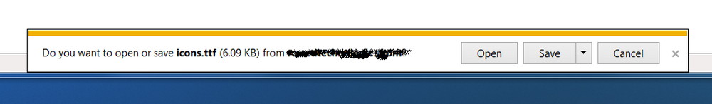

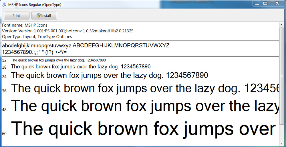

  14. Hey Nick, thanks for the quick reply. When I navigate to https://mywebsite.com/style/icons.ttf I get the "open or save" dialog box (image 1 below). If I select "Open" I get the Font Preview Window (image 2 below). I double-checked the permissions on the various folders and they seem correct. Image 1 Image 2

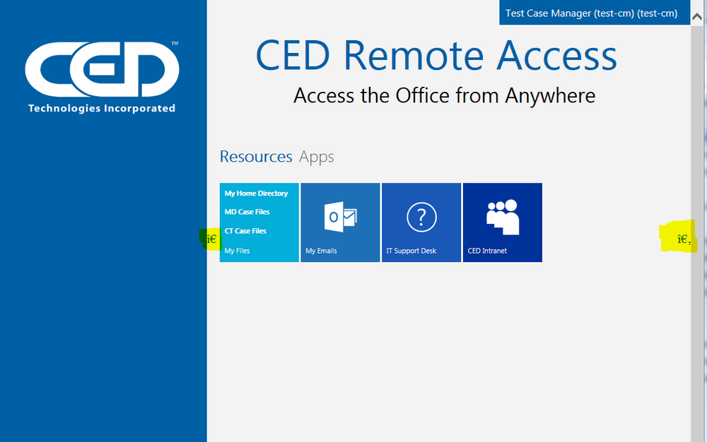

  15. I just upgraded our beta site from 8.7 to 9.0 following the simple upgrade instructions and all seems to be functioning correctly. There is one "visual" issue... After logging in the navigation buttons do not display the image. I am seeing international characters instead (see attached image). the buttons do function correctly though. This happens with both Internet Explorer 10 and Firefox 20. Any thoughts?
