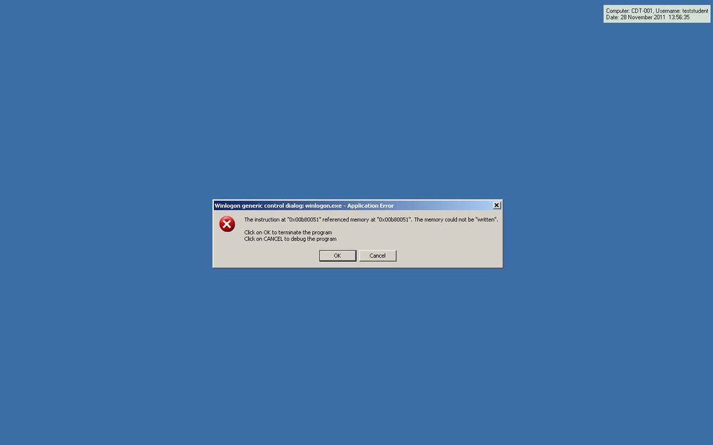

AB Tutor Control V6.7.0 - Winlogon error
Cragzman posted a topic in Network and Classroom Management
Hi All, When I connect to computers and log into them using AB Tutor, some of them display a Winlogon error. Any ideas why this happens? Cheers Cragzman -
