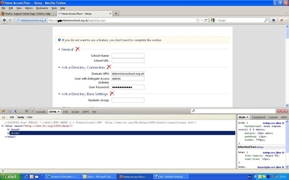

  21. Hi Nick, I now changed the securtiy setting for the IUSER_SERVERNAME account from Deny to Modify on the app_data folder, and from Deny to Read & excute on the HAP folder. I can now start the configuration page, but get and Internal Error everytime I put the Administrator username and passowrd to connect to active directory. [ATTACH=CONFIG]11705[/ATTACH] I am sure that the Domain UPN and username and password are correct. Thanks
