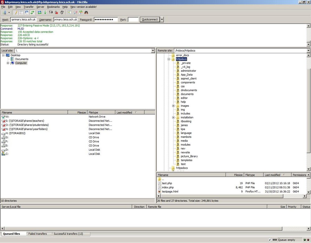

  14. Hi Steve, Has this template been released yet? Our web migration failed due errors in the config.php. We really need to get our site back up and were using the previous version of edugeeks template. Any update would be much appreciated. Cheers!
  15. Hi Steve, I'll give this a go once file permissions have been processed as per Steve21 and Achandler to 644.
  16. Thanks Steve, Achandler, I'll give this a go!
  17. Hi Phil, many thanks for this. We can try this but backing up our ftp will kill our bandwidth during the school day. We'll have to initiate that at the end of the day. We'll try this on Monday morning. The mySQL export and import went reasonably well, although the file was over 6MB which had to split into manageable sub 2MB chunks and then imported in mySQL. This was tested and executed successfully. Do you think there may be an issue here? The configuration.php has been amended accordingly to new mySQL log in details.
  18. Hey Siuko, I've just been in touch with our ISP who confirm that they do use Fasthosts have said php 5 is enabled on the site.
  19. Hi Achandler, The structure of the ftp contains "/htdocs/httpdocs/test.html.
  20. Hi Siuko, I tried as you advised with the test.php and get a "Not Found" page. This page is in the same place as the test.html.
  21. Hi Siuko, our files are accessed through ftp and http://www.kibprimary.leics.sch.uk/test.html does appear when adding the file to the relevant directory. This is the top level of httpdocs. The structure of the ftp is quite long winded and a not very well organised to be honest. The remote site address "/htdocs/httpdocs/images/stories" is used to post School News.
  22. Hi Pete, Yes, we are using version of Joomla which seems to be invented before the internet. We have changed the Username & Password for the mySQL on the configuration.php file. The Host is still listed as "localhost" in all lines of code relating to host.
