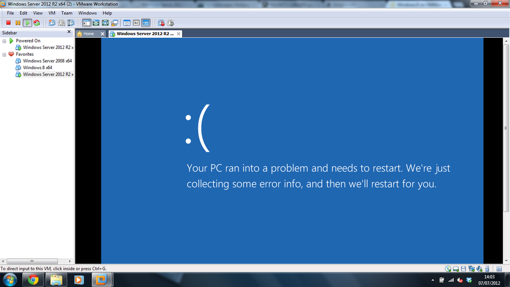

I'm really not having much luck with installing Windows 8. A new error now that I have got VMWare Workstation 8:
I am using VMWare Workstation 7. It was what I had installed on my computer anyway, maybe it could be worth upgrading to VMware Workstation 8 then.
I've got Server 2012 installing at the moment, after some tweaks, on VirtualBox. I think my ISO was wrong with Windows 8. I'm re-downloading it and hoping it will work afterwards.
I'm also getting an error when trying to install Windows Server 2012, see below. Could it be the version of VMWare I'm using?
