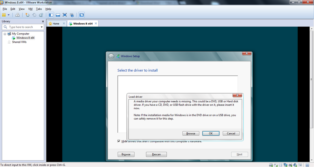

  13. A little update: It was worked fine with VMWare Workstation 8. I must say, I really do not like the Metro UI!
  14. My hash is wrong. Time to download the ISO again for a third time lol! Thanks for your help guys! I may get it installed soon.
  15. I'm really not having much luck with installing Windows 8. A new error now that I have got VMWare Workstation 8:
