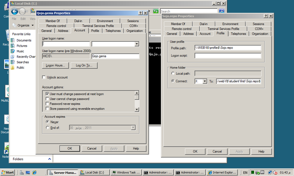

  6. objUser.Put "profilePath", "\\WEB\profile$\" & strUserName 'EDIT -- removed 2 instances of '$' sign this make the profile on Drive C: ??? objUser.Put "homeDrive", "F" objUser.SetInfo objUser.Put "homeDirectory", "\\web\" &strUserName & "$" i understand that the folder will be on the drive directly this make the homeDirectory on Drive C: ??? I make a Drive F on Server Web and i wont to make all the Folders on it how that ? Is that how it should look ? \\web\f\student\first\Qojo genia ???? and do i have to make any Share on the drive or Folders or it will work fine on Hide Share ???? and about the photo in Account ? why isn't the User on the Domain ? thanks for your Time

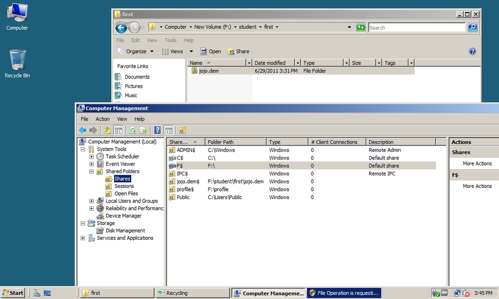

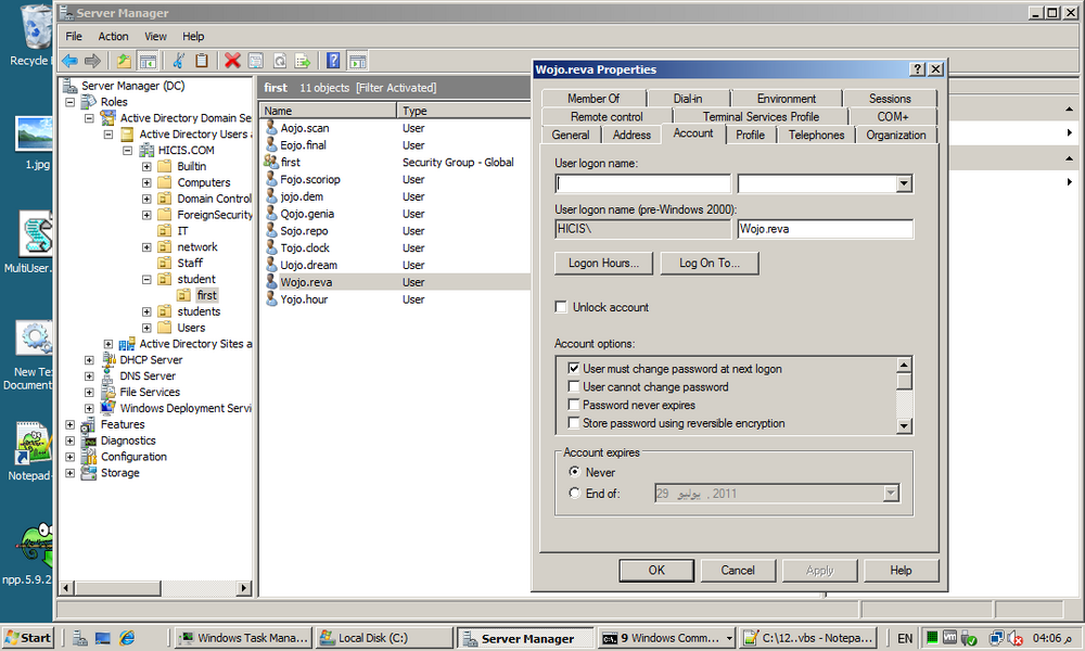

  7. Hello man I can't say how much you help me Finally the Script is Worked there were a same name in all users "jojo" when I change it to deferent names The Script work like magic :D BUT :( Fist of all the Users is not in the Domain I don't know why and this is Account like in photo A and when I try to log in with any user after I complete his information it can't access the Profile folder I don't know why this is the Share folder look's like in The "Web" server and Can I make the Script make a map Drive to the share folder for the Users I will make 1000 user it can't be I will Put the Map drive manual and I need to set the permission on the Share folder to the User who own the folder and Admin only sorry your time I appreciate it so much Thanks a lot I attach The final Ver of The Script and the Users file VIS2.vbs Thanks a lot
  8. i try some thing else and this is the result and this is copy of the Script after all thing it Create First user jojo.dem and make the Share folder on "Web" but stop like you see in there thanks for your time

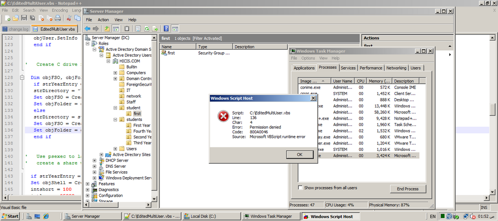

  9. Now i Made the necessary adjustments on the servers and made the hidden shares and all set but i get permission error while the script running i checked the Active directory btw the way i use test VMS to run the script on and i made the share's on C drive , the user is created and added to group but it stops on line 136 "the line that creates the folders" i removed the read only form the folder and i checked i m running the script with admin credit So i need you to check with me again on the creating and sharing part of the script.
