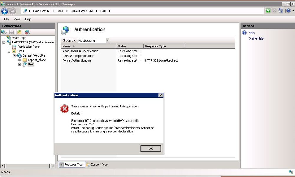

HAP+ Vanilla 2008 (R1) x64 IIS7 Install. Please help
Matt-IT replied to Matt-IT's topic in Home Access Plus+
Ok removed the HAP wwwroot folder and started again. Followed the notes as listed (still dont have an option for IIS AppPool\HAP as this in NOT IIS7.5) Redownloaded HAP ZIP and removed readonly perms. Added Network Service and IIS_WPG to read and execute (modify on the App Data folder). Opened IIS Manager, expanded default site, checked certificate. Converted HAP to an Application. Clicked on Authentication and got this error (see screenshot) -

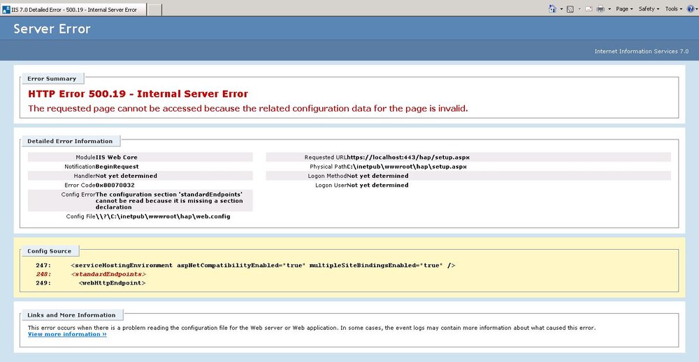

Hi All, I am trying to get my head around installing Home Access Plus and keep running into walls. I have a 2008 (R1) x64 member server - vanilla setup. Installed .Net 4 full and IIS7 from the server manager. No other sites on the IIS. Followed the HAP installation video and created the application pool (unable to set apppool\hap user credentials as IIS7 doenst seem to use them apparently) I get an error when trying to use the default web.config Error on line 248 " 247: 248: 249: " Config Error: The configuration section 'standardEndpoints' cannot be read because it is missing a section declaration I have added a self signed SSL certificate. Created Binding for port 443 Removed binding for port 80 If I remove the < standardEndpoints > section from the web.config the https://localhost/hap/setup.aspx page shows IIS Green Tick Service Activated Red Cross. Any suggestions? Thanks in advance Matt

Reinstalled .NEt 4 from the link in the documentation. Had previosuly installed .net full redist. Didnt make any difference. I got past the error by removing the standardEndpoints section from the web.config entirely. Unfortunately I now have a problem. I cant get certificate to install. Wish there was a guide for doing this with version 8 on IIS 7. I was following the video tutorial which doesnt mention SSL certificates any where. I started follwoing the documentation pdf but thats for IIS6. I tired to import a SSL cert I got from startSSL.com but IIS 7 said the certificate cannot be used. This is giving me a headache..... -

Hi, I am having the exact same symptoms also with a 2008 (not r2) x64 server. Did you ever get it resolved? I tried deleting from the web.config file but that only made the error report the problem on line 247 instead of 248. Did you ever get the problem resolved? Thanks Matt -
