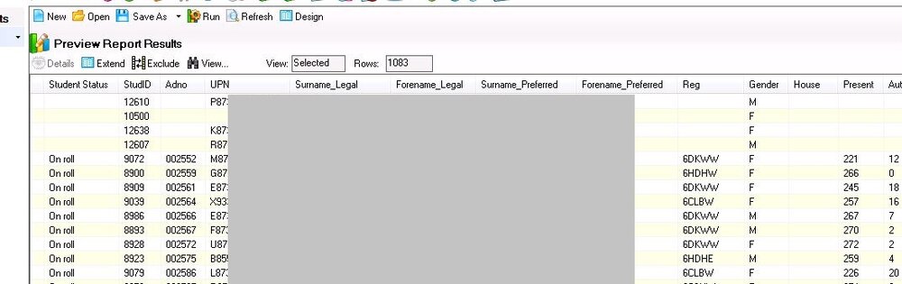

  1. I thought just for reference I would detail here the steps that created the problem in case anyone else experiences it. It appeared to surface after the last SIMS update prior to 9th May 2016 as it didn't happen in earlier years. In spring of 2011 one student was entered as an applicant for Sept 2011 entry but never took up their place In spring of 2013 three students were entered as an applicants for Sept 2013 entry but never took up their places For some reason the data team never marked these four as withdrawn or deleted them following their decision not to accept the place In the spring of 2016 (on 9th May) the data team uploaded into SIMS the new list of applicants for Sept 2016 entry This is where it went wrong Without notifying the user, when the 2016 applicants were entered into SIMS, SIMS also included those four historical applicants from 2011 and 2013 in the 2016 applicant list (it didn't do this in 2014 or 2015) At the same time it assigned a status to just those four such that any report based upon Population: On Roll considered them to be currently on roll Hence, at least in my case, any report based upon Population:On Roll included those four non existent students who were not on roll, had no admission number, no attendance and in one case no UPN. The data team at the school have been able to delete them from the Sept 2016 applicant list, which solves my problem, but I have advised them to report this to Capita as a bug.
  2. I'll tell the school to find out how to delete them, or at least mark them as withdrawn - it's their problem! I quite agree. When it was all a huge set of DB4 files it was relatively straight forward to create a synchronised 'replicated' version of the data in a proper SQL database and then use that copy for analysis. But as soon as they ported it to SQL I had a quick browse to see what was going on and decided it was better to use the tools they provide to extract data for the very reason you suggest - if it goes wrong then its their fault not mine. Thanks to all for your help. At least I now fully understand the problem and I have explained it all to the school. Now its up to them, together with their 'paid for' County ICT support unit, to implement the solution! Regards
  3. Ah, yes I understand. I'll have a go with that as it would be interesting to know what is really in that status field. Might have to be later though as I shall need to go into the school to use that (I work from home using remote access into the school). I'll stick with the exports for data extraction on the grounds that 'if it ain't broke'. Trouble is it looks like something in sims is broke!
  4. No, the only place is in my reports and also they appear in the sims 'general student list report' We have contacted the ICT services for our county and they suggest marking those four as withdrawn in order to explicitly set the status flag. However that doesn't explain why they are suddenly showing up now, after an upgrade. I also notice they are now showing up in many other reports using population students on roll that are nothing to do with me eg ParentPay and GroupCall exporter to various external bodies like go4schools and sisra. I think we shall have to delete them.

  6. No, that's also odd. They don't appear in the student search with status selected as , current, guest or any of the other possible values. They only appear in reports.
  7. @jinnantonnixx Yes they look like they have a status of null, and a null admin number - that's what is causing the null conversion error in the external program. How would I check what is actually in that field? After all an empty string could look like null on the screen. Come to think of it how could an empty string get in there anyway and why would it suddenly appear now?
  8. Hello Bob, glad you picked up my post. It gets worse, when I added the admission date and leaving date I got some really strange dates - see below. That would seem to indicate that the data team is wrong, they are not pre-admissions for sept 2016 but from much earlier. But those students have never been exported before now and the report hasn't changed for ages. I might add that I don't deal with the data entry side of sims at all, the data team do that. My role is the analytical processing the data that is already in sims
  9. I have several SIMS reports that export data to xml files every night for further processing externally. All of them are based on: Data area: Student - Population: On Roll They have all been running fine for a year or so. On 9th May the external processing reported an error which I traced to the reports exporting four students who were not on roll and did not have an admission number or any attendance record. They had simply been entered into SIMS by the data team as being accepted for a September 2016 intake. As a test I added the student status field to one of the reports and you can see that the status is not shown as 'on roll', so they shouldn't have been exported. We are running SIMS Build 50 ver 7.168. Is this a bug introduced by the latest upgrade? Below is the design of one of my reports and the preview showing the four students who should not be there I think I may be able to do a workaround by explicitly adding a filter where student status is 'on roll', but I've never had to do that before. Any other suggestions?
