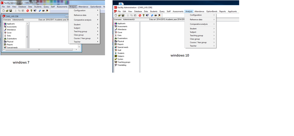

  16. Has anyone else had this issue in windows 10?? Some of the applications we use at school (facility for example) looks much brighter in colour than windows 7 ie see the picture the menus look white compared to on windows 7 I have messed around with themes and brightness but cannot seem to get it to look like windows 7 I can imagine some users not liking this any advice is greatly appreciated as I am now close to rolling this out to the office staff
