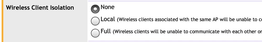

It sounds to me like you might have "wireless client isolation" turned on for the WLAN (Configure > WLANs) in ZoneDirector.
