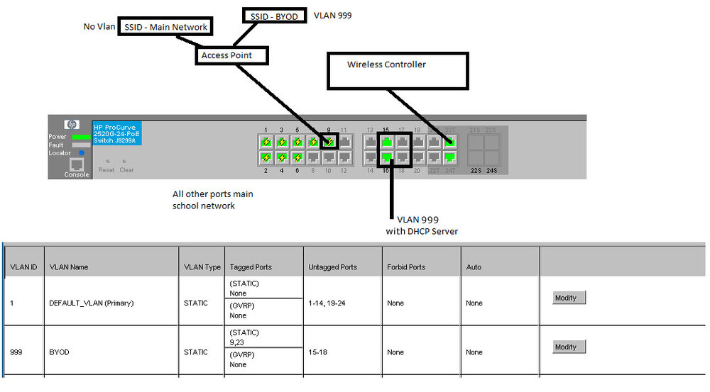

  2. Thank you for this. If I setup the Internet Port should that be connected to a port on the Guest VLAN?
  3. Thank you for this. I have setup as suggested. Everything works until i tunnel guest traffic to the controller. Any suggestions?
  4. Thank you for your replies and help. We have the HP MSM760 controller.
  5. Do you mean make the port the controller is connected to a trunk?
  6. Thank you for your reply. When I tag port 9 the AP does not provision or connect to the controller. I can also ping from the controller to an IP on Vlan 999.
  7. I am wanting to setup a VLAN on one network switch as per diagram attached. VLAN 999 has a dedicated DHCP server. I have setup the wireless network so all traffic from the BYOD SSID is tagged 999. If I connect using a cable into VLAN 999 I can ping all devices in that VLAN. If I connect using a wireless device I can’t ping. Can anyone help?
