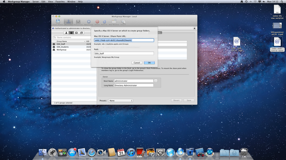

  13. Right here is my next problem, here i am setting up the windows network shares to be mapped on the macs, i have the magic triangle setup and am, I have setup 2 groups in LDAP on my mac server that are OSX_Staff and OSX_students and added the groups i want as members. Now i have added the windows shares i want mapped to those user groups. Here us a screenshot of what i am doing, and the problem i am getting. Everytime i create the share for //servername/shared work, it keeps appending the group name. So when i log in the macs and click the mapped drive it actually goes to //servername/shared work/*Group name* Where as i just want to it go to the root folder //servername/shared work/ What am i doing wrong? every time i delete the group name from path and save it reappears
