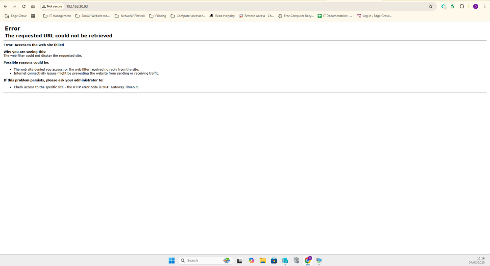

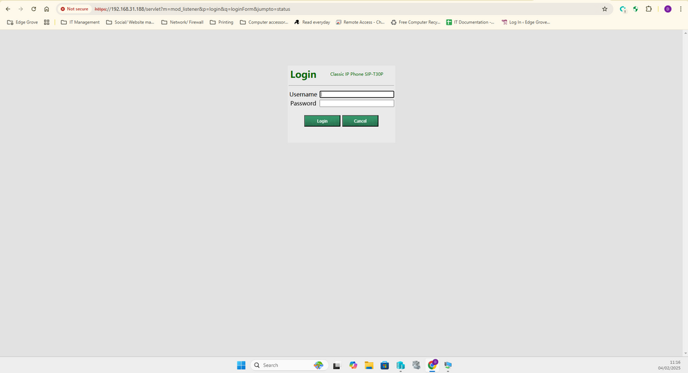

  5. @MatthewL here are the screenshots of me connecting to the IP phone and then the IP tannoy. the phone and the tannoy are on the same vlan but from what I can see theyre on a different subnet which is weird.
  6. When I was told to facotry reset it from the company I have done this and it grabs a new IP address from DHCP automatically. I believe I have tried the old IP address it had but I still get the same issue the requested URL could not be retrieved error which is very strange becuase I used to be able to connect to it by typing in the I paddress. I can connect to all the other phones on the network on my laptop but for some reason not this system. [h=2][/h]
  7. Hi, I have been working on an issue since forever. This IP tannoy speaker connects to the network through DHCP and when I type this into my search bar this gives me an error connecting to it and it just refuses the connection every time. I have no idea why this is because it was working before when it had a different IP address in the same subnet but now it is just like it is acting by itself. Has anyone got any idea what could be the problem? I have been working on this issue for nearly a week and I am out of ideas as of why this is just being rogue.
