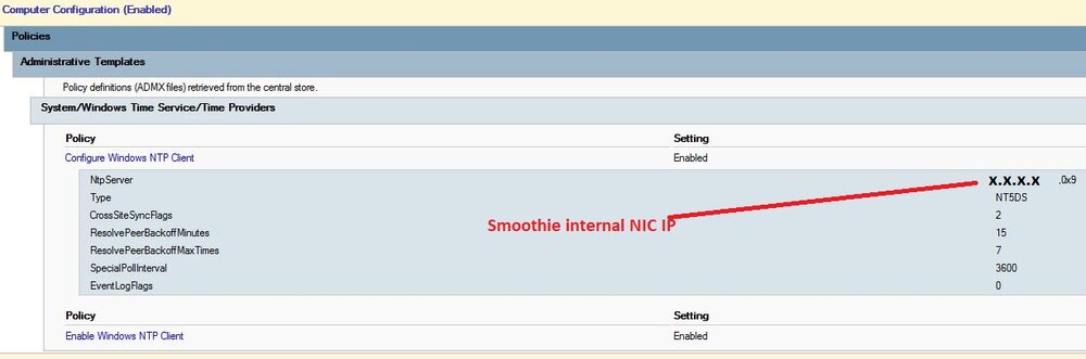

Thanks for that. I'll admit I checked it out and it confused me slightly more than before. Ok the principle I'm taking away from this is that if and so long as the PDC has the correct time if no other setting at all is set in Group Policy then all clients should eventually get the correct time. From the clock on the PDC. Hopefully that part is at least correct. I haven't worked to this principle currently but at least if this one fundamental thing is right then I can start somewhere. Second thing I'm trying to do is set my Smoothie box as NTP server, with the IP of the local LAN interface being the IP I should imagine we'd set as the NTP server address in any policies we'd be writing. With that in mind I'd assume the following would be ok, but which currently doesn't seem to work: WMI Filter on this one to apply to PDC only: (blanked out internal NIC IP of Smoothie) "Enable Windows NTP Client policy" set to "enabled" and "Enable Windows NTP Server" also enabled. WMI filter on this one to apply to non-PDCs only: "Enable Windows NTP Client policy" set to "enabled" and "Enable Windows NTP Server" also enabled here too. Time now 2 mins out on the PDC vs clients, running gpupdate /force on clients doesn't bring time into line, w32tm /resync /rediscover on clients gives an error "The computer did not resync because no time data was available" and I'm starting to get a little lost now. Thanks any/everyone for sticking with me on this. -

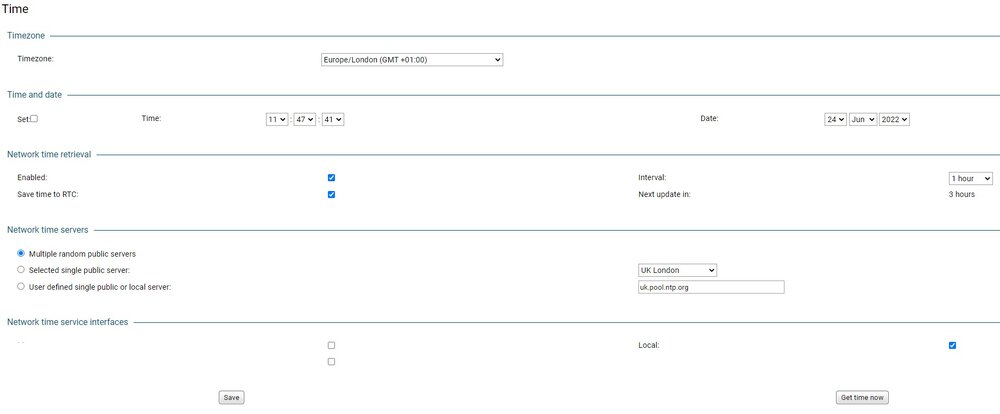

Thanks much everyone. Ok I think I'm getting there on the principles of it, but I'm still lost as to what we're doing here. Un-picking things here we have inherited, and it looks like a LOT of options have been "explored" in the past. Firstly, just to try and get an easy* option, can I set a top-level policy to just have all clients look to the Smoothwall box to be NTP server? If anyone's done that, are the settings any different to the below? Having of course configured the options in Smoothie to be NTP server, and make it available on the LAN, which I *think* I've done right here: I think this should work, however I'm worried (or rather I just don't know) if then any current DCs will just "take" this setting and not be trying to argue with each other/with the Smoothwall box over who is rightful NTP server and send everything bonkers. (Also did specifically check none of the DCs, all being VMs, are getting any time settings form the hosts they've all got that option un-ticked.) Thanks everyone helping me through this! -

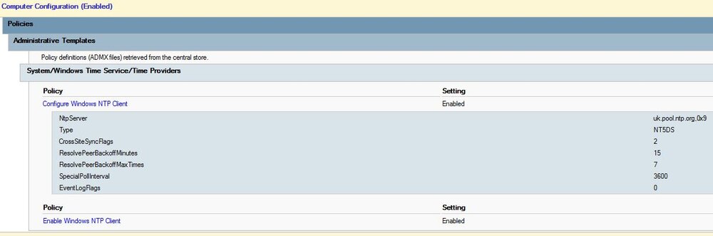

Hello everyone, Have a strange issue here which has worked at another school perfectly. Just doesn't seem to work out here and trying to figure out why. These are the only settings applied in the policy: Didn't seem to horrid a prospect for workstations to check in with that pool every hour. But nothing is and times are still wacky. RSOP shows workstations "get" it, they just don't "pay attention" kinda! The only clue I have is if I look to a workstation that should get this setting, I see the Time server (in Date and Time) as one of our local DCs. I would HOPE though that this DC would "take" the policy (it is applied at the very top level.) Not sure where else to check for mischief and non-compliance, anyone have any hints or good ideas on where to start looking? Thanks much everybody.
