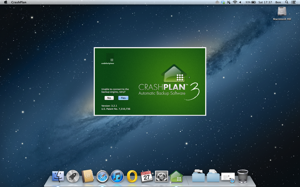

Ok so i have installed the crashplan agent on my mac but it refuses to open just comes uo with:
"unable to connect to backup engine, Retry?"
but on my pc and server its working fine.
i have all software updates upto date and java installed
[ATTACH=CONFIG]15843[/ATTACH]
Where did you install it to? Pretty sure it had to be in a certain place on Mac's to work, will try to find the kb.
Edit - here he is:
Mac
The full path to the CrashPlan.app file must be /Applications/CrashPlan.app. If you've moved or renamed CrashPlan.app, you may see the “Unable to connect to the local backup engine” error upon starting the CrashPlan desktop. To resolve this, uninstall and reinstall CrashPlan.
Contact Support
Steve
Edited by Steve21
I am unable to find the Java preferences app :(
That must mean you do not have Apple's version of Java installed. Did you install Oracle's JRE? If not, try downloading the latest version from here (jre-7u9-macosx-x64.dmg).
