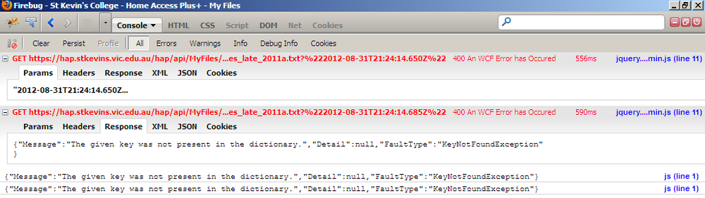

peterdwyer Posted August 31, 2012 Author Posted August 31, 2012 G'day Installed Firebug and captured the HTML code in the attached text file. I'm not familiar with the package so please let me know if I've got the wrong information for you. BTW Also tried on Safari v5.1.7 with same result ThanksHAP_Firebug_output.txt
peterdwyer Posted August 31, 2012 Author Posted August 31, 2012 Or perhaps this is what you were looking for. Apologies if I've got it wrong. I got this from http://www.edugeek.net/forums/home-access-plus/86059-hap-json-debugging.html Thanks https://hap.stkevins.vic.edu.au/hap/api/MyFiles/Exists//install_changes_late_2011a.txt?%222012-08-31T08:39:16.915Z%22 XML Tab XML Parsing Error: not well-formed Location: moz-nullprincipal:{a4cf6032-8349-4d5c-bd52-c52a1d112a03} Line Number 1, Column 1: {"Message":"The given key was not present in the dictionary.","Detail":null,"Fau... ^ {"Message":"The given key was not present in the dictionary.","Detail":null,"FaultType":"KeyNotFoundException"} js (line 1) {"Message":"The given key was not present in the dictionary.","Detail":null,"FaultType":"KeyNotFoundException"} JSON Tab Message "The given key was not present in the dictionary." Detail null FaultType "KeyNotFoundException" https://hap.stkevins.vic.edu.au/hap/api/MyFiles/Exists//install_changes_late_2011a.txt?%222012-08-31T08:39:16.935Z%22 XML Tab XML Parsing Error: not well-formed Location: moz-nullprincipal:{f3bc5274-18d0-439f-895a-b72e94ac0684} Line Number 1, Column 1: {"Message":"The given key was not present in the dictionary.","Detail":null,"Fau... ^ {"Message":"The given key was not present in the dictionary.","Detail":null,"FaultType":"KeyNotFoundException"} js (line 1) {"Message":"The given key was not present in the dictionary.","Detail":null,"FaultType":"KeyNotFoundException"} js (line 1 JSON Tab XML Parsing Error: not well-formed Location: moz-nullprincipal:{f3bc5274-18d0-439f-895a-b72e94ac0684} Line Number 1, Column 1: {"Message":"The given key was not present in the dictionary.","Detail":null,"Fau... ^ {"Message":"The given key was not present in the dictionary.","Detail":null,"FaultType":"KeyNotFoundException"} js (line 1) {"Message":"The given key was not present in the dictionary.","Detail":null,"FaultType":"KeyNotFoundException"} js (line 1)

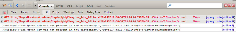

peterdwyer Posted August 31, 2012 Author Posted August 31, 2012 I'm sorry - I'm not familiar with Firebug or how to get the information that you are after. I couldn't find a tab called "Post". Here are two screen shots of what tab options were displayed. It would be appreciated if you could direct me to the right spot Thanks
nickbro Posted September 1, 2012 Posted September 1, 2012 Should be fixed in v8.0.0901.1830. To upgrade replace ~/myfiles/default.aspx with the one in the release. Home Access Plus+ - Download: v8.0 1
