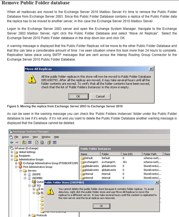

I used instructions published by Jaap Wesselius. Upgrade Exchange 2003 to Exchange 2010 - Part II I have attached a screen dump showing how far I got before I was unable to proceed.

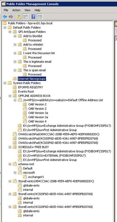

I have attached a screen dump from Exchange 2010 >Toolbox > Public Folder Management Console, may be it will help? Apart from the GFI sub-folders none of the rest have any files.

I'm assuming you're meaning to remove the folder indicated in red on the attached image.
What about the folder indicated in orange, I believe that is part of Exchange 2003, or am I missing the mark completely?
I've also found another mention of HPSS02 as [CN=Connections > CN=SMTP (HPSS02-{484CC3AC-208B-4559-AEF0-4DEF68882DDC})] can this be removed?

sukh, many thanks for all your help so far.
yes thats what I mean, can you post an image of the smtp path or state it?
Not quite certain what path you mean, I hope it is the AD path which is
Configuration (Domain) > CN=Configuration etc > CN=Services > CN=Connections > CN=SMTP etc
So, finally, can the 'CN=First Administrative Group' go and what about the 'System Public Folders in Exchange 2010, can they go?
