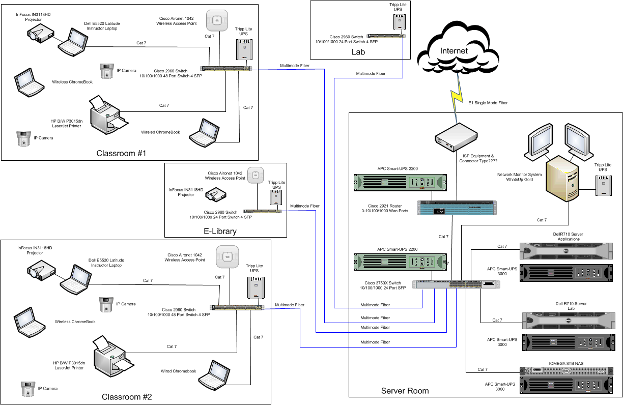

TZ112 Posted June 24, 2012 Posted June 24, 2012 Hi, I am in need of a little help, I am currently re-installing a network with all new equipment and need some guidance in configuring mutliple VLANs on a switched network. I will be utilizing 4 Cisco 2960 Switches(user switches), a Cisco 3750-X Switch(Core switch), and Cisco 2921 router as the backbone devices. I already configured them with the basic information in order to test them out for connectivity, however I am still unsuccessful/unsure in properly configuring them utilizing seperate/multiple VLAN's between all the devices. I want to use the 10.17.0.0 network information, utilizing NAT of course and then use 10.17.1.0 network on one switch utilizing VLANs, x.x.2.0 on another, x.x.3.0, x.x.4.0 ect. networks, on the other switches. Can anyone assist me in the right direction? Here is the example of basic configs (minus sensitive information) that I installed for testing purposes and everything is working fine, however now I want to seperate the devices, and put them on their own networks, and then eventually segment the switches on seperate sub-vlans. I will also attach a basic diagram as a reference of the equipment. Thanks for the help. Router: version 15.1 no service pad service tcp-keepalives-in service tcp-keepalives-out service timestamps debug datetime service timestamps log datetime service password-encryption service sequence-numbers no service dhcp ! hostname rtr ! boot-start-marker boot-end-marker ! ! security passwords min-length 10 logging buffered critical logging rate-limit 10 ! aaa new-model ! ! aaa authentication login default local-case aaa authorization console aaa authorization exec default if-authenticated ! ! ! ! ! aaa session-id common clock timezone **omitted** clock calendar-valid ! no ipv6 cef ip source-route no ip gratuitous-arps ip cef ! ! ! ! ! no ip bootp server no ip domain lookup ip domain name **omitted** multilink bundle-name authenticated ! ! password encryption aes crypto pki token default removal timeout 0 ! crypto pki trustpoint **omitted** ! ! crypto pki certificate chain **omitted** ! ! username **omitted** username **omitted** username **omitted** ! ! ip ssh version 2 ! ! ! ! interface Embedded-Service-Engine0/0 no ip address shutdown ! interface GigabitEthernet0/0 description THE NEW ISP INFO LIVE! $OUTSIDE$ no ip address ip flow egress ip nat outside no ip virtual-reassembly in ip virtual-reassembly out max-reassemblies 128 duplex auto speed auto no cdp enable ! interface GigabitEthernet0/1 description Link to CoreSW ip address 10.17.1.1 255.255.0.0 ip flow ingress ip nat inside ip virtual-reassembly in max-reassemblies 128 duplex full speed auto ! interface GigabitEthernet0/2 description **NOT USED** no ip address shutdown duplex auto speed auto ! ip forward-protocol nd ! no ip http server ip http access-class 23 ip http authentication local no ip http secure-server ip http timeout-policy idle 60 life 86400 requests 10000 ip flow-export destination 10.17.3.250 2055 ! ip nat inside source list 117 interface GigabitEthernet0/1 overload ip route 0.0.0.0 0.0.0.0 10.17.0.0 name **omitted** ! ip access-list extended netbios deny tcp any any eq 135 deny udp any any eq 135 deny tcp any any eq 136 deny udp any any eq 136 deny tcp any any eq 137 deny udp any any eq netbios-ns deny tcp any any eq 139 deny udp any any eq netbios-ss deny tcp any any eq 445 deny udp any any eq 445 deny tcp any any eq 138 deny udp any any eq netbios-dgm permit ip any any ! logging trap warnings logging 10.17.3.250 access-list 100 permit ip 10.0.0.0 0.255.255.255 any access-list 100 remark **omitted** Category=128 access-list 100 permit ip host 255.255.255.255 any access-list 100 permit ip 127.0.0.0 0.255.255.255 any access-list 117 permit ip any any ! ! snmp-server community **omitted** snmp-server enable traps tty ! ! ! control-plane ! ! banner login ^C LOG OFF IMMEDIATELY IF YOU DO NOT AGREE TO THE CONDITIONS STATED IN THIS WARNING ^C banner motd ^C NOTICE TO USERS THIS IS A PRIVATE COMPUTER SYSTEM. It is for authorized use only. Users (authorized or unauthorized) have no explicit or implicit expectation of privacy. Any or all uses of this system and all files on this system may be intercepted, monitored, recorded, copied, audited, inspected, and disclosed to authorized site and law enforcement personnel, as well as authorized officials of other agencies, both domestic and foreign. By using this system, the user consents to such interception, monitoring, recording, copying, auditing, inspection, and disclosure at the discretion of authorized site personnel. Unauthorized or improper use of this system may result in administrative disciplinary action and civil and criminal penalties. By continuing to use this system you indicate your awareness of and consent to these terms and conditions of use. ^C ! line con 0 exec-timeout 5 0 line aux 0 no exec line 2 no activation-character no exec transport preferred none transport input all transport output pad telnet rlogin lapb-ta mop udptn v120 ssh stopbits 1 line vty 0 4 access-class **omitted** in privilege level 15 transport input ssh line vty 5 15 access-class **omitted** in privilege level 15 transport input ssh ! scheduler max-task-time 5000 scheduler allocate 20000 1000 ntp server 196.43.1.9 end Core switch: version 12.2 no service pad service timestamps debug uptime service timestamps log uptime no service password-encryption ! hostname **omitted** ! boot-start-marker boot-end-marker ! enable secret 5 **omitted** enable password **omitted** ! username **omitted** username **omitted** username **Omitted** no aaa new-model clock timezone **omitted** switch 1 provision ws-c3750x-24s system mtu routing 1500 no ip sticky-arp ip dhcp excluded-address 10.17.3.250 ip dhcp excluded-address 10.17.2.249 10.17.2.255 ip dhcp excluded-address 10.17.0.1 ip dhcp excluded-address 10.17.1.0 10.17.1.15 ! ip dhcp pool 1 network 10.17.0.0 255.255.0.0 default-router 10.17.1.1 dns-server 8.8.8.8 8.8.4.4 ! ip dhcp pool jv1 host 10.17.2.250 255.255.0.0 dns-server 8.8.8.8 8.8.4.4 ! ip dhcp pool jv2 host 10.17.2.249 255.255.0.0 dns-server 8.8.8.8 8.8.4.4 ! ip dhcp pool console host 10.17.3.250 255.255.0.0 dns-server 8.8.8.8 8.8.4.4 ! ip dhcp pool user_bad_wifi_card host 10.17.3.80 255.255.0.0 ! ip dhcp pool Slim host 10.17.3.50 255.255.0.0 dns-server 8.8.8.8 8.8.4.4 ! ! ip domain-name **omitted** ! ! crypto pki trustpoint **omitted** ! ! crypto pki certificate chain **omitted** spanning-tree mode pvst spanning-tree extend system-id ! ! ! ! vlan internal allocation policy ascending ! ip ssh version 2 ! ! ! ! ! interface FastEthernet0 no ip address ! interface GigabitEthernet1/0/1 description Link to Router switchport trunk encapsulation dot1q switchport mode trunk ! interface GigabitEthernet1/0/2 description Link to For switchport trunk encapsulation dot1q switchport mode trunk ! interface GigabitEthernet1/0/3 description Link to Class1 switchport trunk encapsulation dot1q switchport mode trunk ! interface GigabitEthernet1/0/4 description Link to ELibrary switchport trunk encapsulation dot1q switchport mode trunk ! interface GigabitEthernet1/0/5 description Link to Class2 switchport trunk encapsulation dot1q switchport mode trunk ! interface GigabitEthernet1/0/6 description **NOT USED** switchport mode access shutdown ! interface GigabitEthernet1/0/7 description **NOT USED** switchport mode access shutdown ! interface GigabitEthernet1/0/8 description **NOT USED** switchport mode access shutdown ! interface GigabitEthernet1/0/9 description **NOT USED** switchport mode access shutdown ! interface GigabitEthernet1/0/10 description **NOT USED** switchport mode access shutdown ! interface GigabitEthernet1/0/11 description **NOT USED** switchport mode access shutdown ! interface GigabitEthernet1/0/12 description **NOT USED** switchport mode access spanning-tree portfast shutdown ! interface GigabitEthernet1/0/13 switchport mode access spanning-tree portfast shutdown ! interface GigabitEthernet1/0/14 description **NOT USED** switchport mode access shutdown ! interface GigabitEthernet1/0/15 description **NOT USED** switchport mode access shutdown ! interface GigabitEthernet1/0/16 description **NOT USED** switchport mode access shutdown ! interface GigabitEthernet1/0/17 description **NOT USED** switchport mode access shutdown ! interface GigabitEthernet1/0/18 description **NOT USED* switchport mode access shutdown ! interface GigabitEthernet1/0/19 description **NOT USED* switchport mode access shutdown ! interface GigabitEthernet1/0/20 description **NOT USED* switchport mode access shutdown ! interface GigabitEthernet1/0/21 description **NOT USED* switchport mode access ! interface GigabitEthernet1/0/22 description **NOT USED* switchport mode access shutdown ! interface GigabitEthernet1/0/23 description **NOT USED* switchport mode access shutdown ! interface GigabitEthernet1/0/24 description **NOT USED* switchport mode access shutdown ! interface GigabitEthernet1/1/1 description **NOT USED* shutdown ! interface GigabitEthernet1/1/2 description **NOT USED* shutdown ! interface GigabitEthernet1/1/3 description **NOT USED* shutdown ! interface GigabitEthernet1/1/4 description **NOT USED* shutdown ! interface TenGigabitEthernet1/1/1 ! interface TenGigabitEthernet1/1/2 ! interface Vlan1 ip address 10.17.1.2 255.255.0.0 no ip route-cache cef no ip route-cache ! ip http server ip http secure-server ! ! logging esm config logging trap warnings logging 10.17.3.250 access-list 1 permit 10.17.1.1 access-list 1 permit 10.17.1.2 access-list 1 permit 10.17.1.3 access-list 1 permit 10.17.1.4 access-list 1 permit 10.17.1.5 access-list 1 permit 10.17.1.6 access-list 1 permit 10.17.2.249 access-list 1 permit 10.17.2.251 access-list 1 permit 10.17.3.250 access-list 1 permit 10.17.2.250 snmp-server community **omitted** snmp-server enable traps tty ! ! line con 0 login local line vty 0 4 access-class 1 in password **omitted** login local line vty 5 15 access-class 1 in password **omitted** login local ! endDiagram(Helper).bmp

twin--turbo Posted June 24, 2012 Posted June 24, 2012 And your running a trunk on the 3750 pointing at the router but the router does not have a trunk port. Rob
twin--turbo Posted June 24, 2012 Posted June 24, 2012 (edited) This is all fairly ancient stuff BTW.. Who's the ISP and what equipment are they providing, A 2921 aint a cheap bit of kit.. The APC 2200's on the core and 2921 are overkill too. Rob Edited June 24, 2012 by twin--turbo
twin--turbo Posted June 24, 2012 Posted June 24, 2012 (edited) Where do you want your internal network routing to happen on the 2921, or on the 3750 if the latter.. Get VTP on and confirm that the clients update their Vlandatabases. Set up Vlan Interfaces on the core with an IP address. Assign switchport access vlans to ports on the switches. Change G0/1 to a access port, remove the IP address and assign it to vlan1 set up default route on the 3750 as the 2921, and set static routes on the 2921 for the internal networks. IS the Internet link really an E1??????? Rob Edited June 24, 2012 by twin--turbo

TZ112 Posted June 24, 2012 Author Posted June 24, 2012 Where do you want your internal network routing to happen on the 2921, or on the 3750 if the latter.. Get VTP on and confirm that the clients update their Vlandatabases. Set up Vlan Interfaces on the core with an IP address. Assign switchport access vlans to ports on the switches. Change G0/1 to a access port, remove the IP address and assign it to vlan1 set up default route on the 3750 as the 2921, and set static routes on the 2921 for the internal networks. IS the Internet link really an E1??????? Rob I want the "internal networking" to happen from the Core switch and just the routing functions to happen from the 2921 router for now (until I expand the Network). Yes I have a dedicated Fiber Line already terminated to my building, from the ISP. I know that it might seem a little overkill, however I am looking into the futre and want to expand the network soon.
TZ112 Posted June 24, 2012 Author Posted June 24, 2012 This is all fairly ancient stuff BTW.. Who's the ISP and what equipment are they providing, A 2921 aint a cheap bit of kit.. The APC 2200's on the core and 2921 are overkill too. Rob The ISP is very...let's just say not very informative, however they give me enough infformation to set up the external (WAN) link. As far as the equipment, all I get from them is the modem, the external link (fiber...as an agreement) and the fiber converter to my switch (which should be insiginficant in this matter for now). As far as the rest of the equipment, I flipped the bill for this and I know it might seem a little overkill, however, I want to make sure that the network, equipment, and services are running without any problems.

TZ112 Posted June 24, 2012 Author Posted June 24, 2012 You need layer 3 routing somewhere for your vlans to talk. Either the 3750 must do the routing or the 2921 must do the vlan routing. Rob Thanks... It is a judgment call that I had to make, however seeing that the the network is going to be set up they way that it is (according to the diagram), I figured that I would just make the "core" switch 3750 do the basic DHCP services for the rest of the switches, and the 2921 Router to as it was functioned to do and be the VLAN routing. That is the problem that I am running into, with having two simultaneous devices that can almost basically do the same Layer 3 services. Also which one gets the configurations? What do you suggest?
twin--turbo Posted June 24, 2012 Posted June 24, 2012 (edited) Do the L3 on the 3750. Otherwise your running the 2921 as a Router on a stick and just shoveling data up adn down a pipe for no reason. Rob Edited June 24, 2012 by twin--turbo
