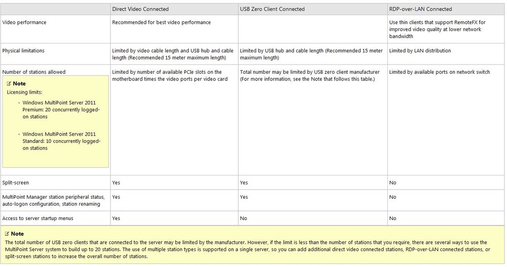

Would that amount of zero clients not even work over USB3?
we're initially looking at 10 at the moment but may expand it further. So as i understand it id need to run x amount over usb and x over the network as well?
Thanks for the replies guys.
USB would put a massive toll on it as it not only has to use the CPU to generate each user session but each client shows up as a moniter and audio device on that system that also has to be powered by the CPU.
If any USB3 zeroclients existed then it may make the USB overhead a little less of an issue but as far as I know they are all USB2 so far and so the ports would step down to USB2 anyway.
For comparision we spec our direct GPU connected four stations with 8GB, and i7 2600 and SSD, our six station ones are 16GB with the same other specs and they don't have to handle the overhead of both rendering and displaying (over a CPU bound USB VGA adapter).
If you're looking at USB (or USB-over-TCP/IP) terminals there is normally a limit imposed by the terminal manufacturer of 14 or 15.
If you want 20 stations on a single server I think you have to use an RDP based terminal....
USB based are faster for lower numbers of terminals - but as the number increases the performance deteriorates, whereas with RDP terminals, the performance is not quite so good to start with
- but remains constant up to the full quota of 20 workstations
