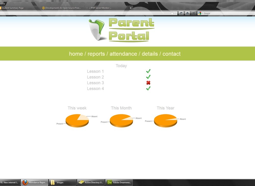

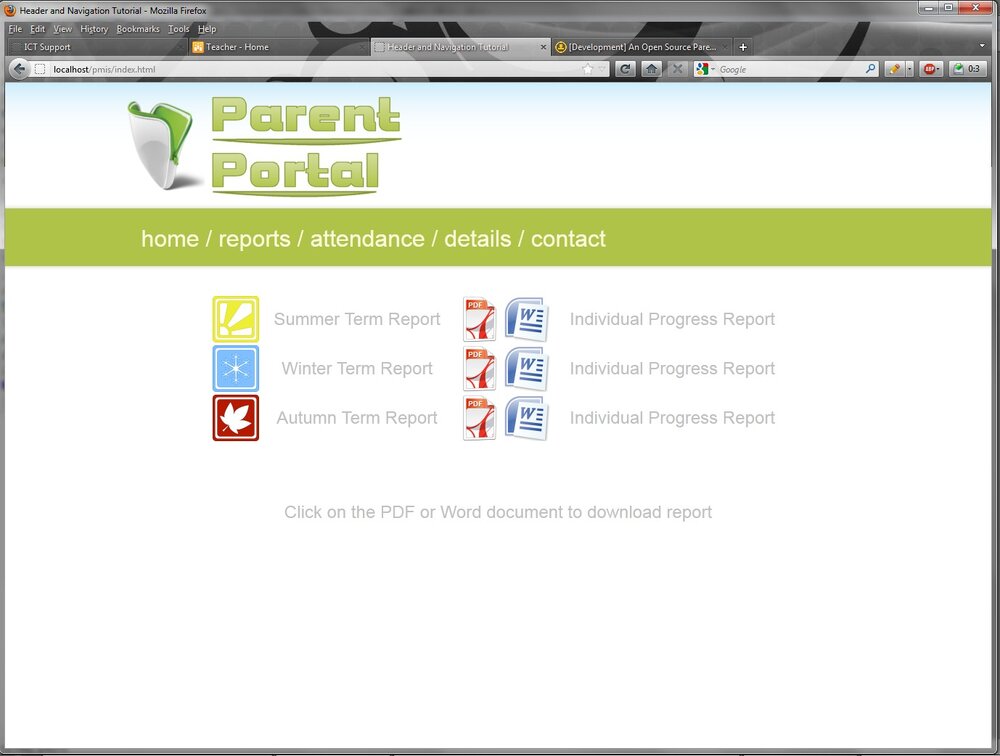

Managed to get the site layout working now.
I also wrote a little vb command app that searches the document server for the relevant reports. It works in concept but quite dangerous searching by wildcards I think :) Just a proof of concept for now. I'm sure there are better ways to do it.
So I'm up against encrypted documents now. :/
Edited by zag
