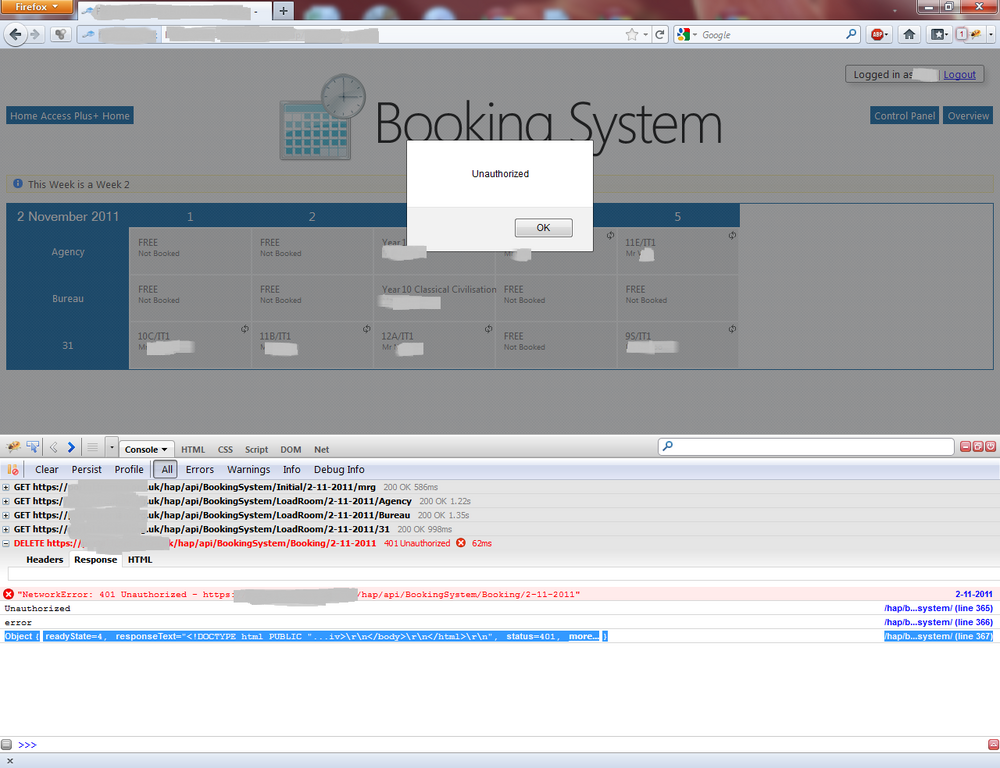

Okay, i'll focus on the "delete a booking" issue.
So, in firefox i get a pop-up box which says "Unauthorised".
Firebug shows:
DELETE https://portal.freman.org.uk/hap/api/BookingSystem/Booking/2-11-2011 401 Unauthorized 62ms
[X] "NetworkError: 401 Unauthorized - https://portal.freman.org.uk/hap/api/BookingSystem/Booking/2-11-2011"
Unauthorized /hap/b...system/ (Line 365)
error /hap/b...system/ (Line 366)
Object { readyState=4, responseText="
The expanded "response|Text" from the error is:
401 - Unauthorized: Access is denied due to invalid credentials.
You do not have permission to view this directory or page using the credentials that you supplied.
