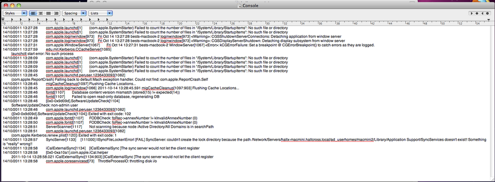

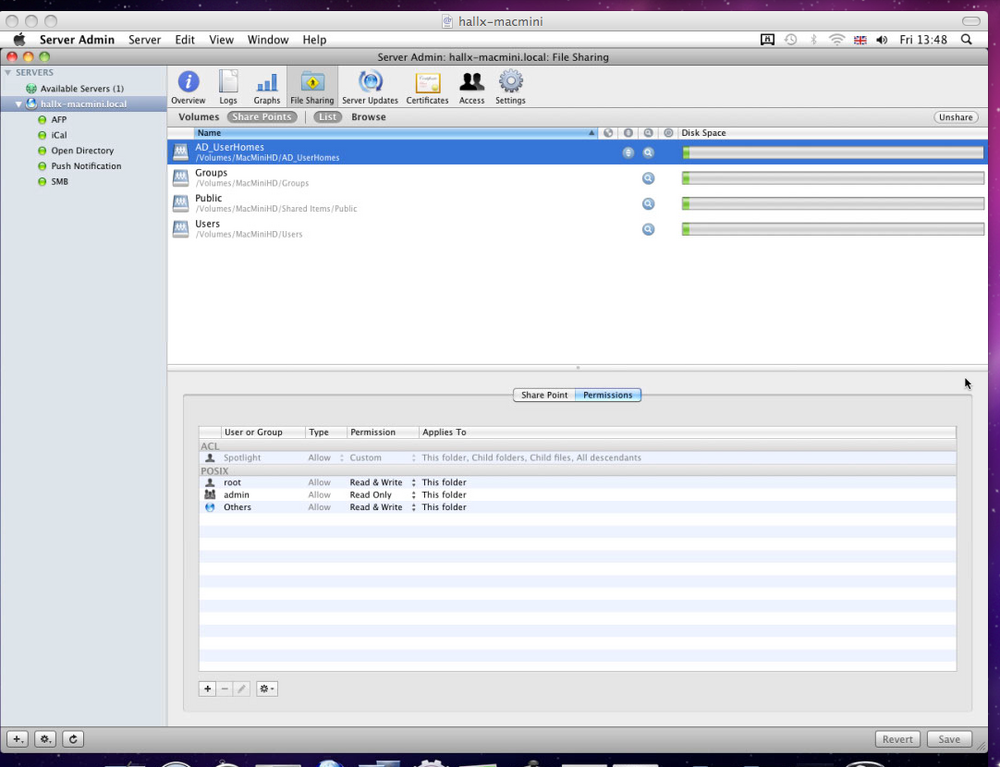

I've attached the console log (which may as well be written in Chinese :-D) and a screenshot of the permissions set on the home folder sharepoint.
