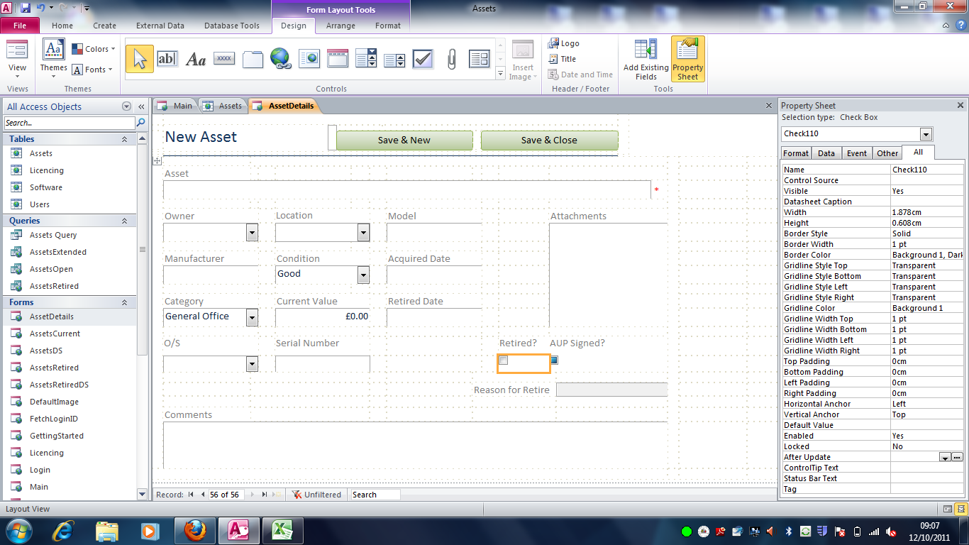

jonathon28 Posted October 12, 2011 Author Posted October 12, 2011 Sorry, I can't find an 'on click' option either for the checkbox. see attached screenshot.
LosOjos Posted October 12, 2011 Posted October 12, 2011 Sorry, I can't find an 'on click' option either for the checkbox. see attached screenshot. [ATTACH=CONFIG]11592[/ATTACH] In the "properties" panel on the right hand side of the screen, change to the "Event" tab; do you see it there?
LosOjos Posted October 12, 2011 Posted October 12, 2011 no i just get 'After Update'. OK well that should work actually, click the drop down box and choose "Event Procedure". If it doesn't say that and instead gives you choices like "Macro Builder" and "Code Builder" - choose Code Builder. Your code should look like this (although I haven't changed the name of the text box, you'll still have to do that): Private Sub Check110_AfterUpdate() Text1.Enabled = Check110.Value End Sub
