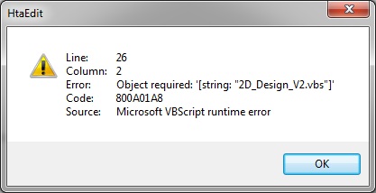

Set objOption = objFile.Name
objOption.text = objFile.Name
objOption.Value = objFile.Name
Why?
If all you want is to add the name to it, you won't even need objects as such.
Steve

I have fixed it. replace the for each with the following
For Each objFile in colFiles
Set objOption = Document.createElement("OPTION")
objOption.Text = objFile.Name
mylistbox.Add(objOption)
Next
hope this helps some one and thank you for your reply Steve21
