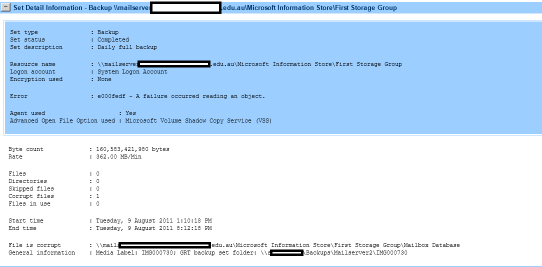

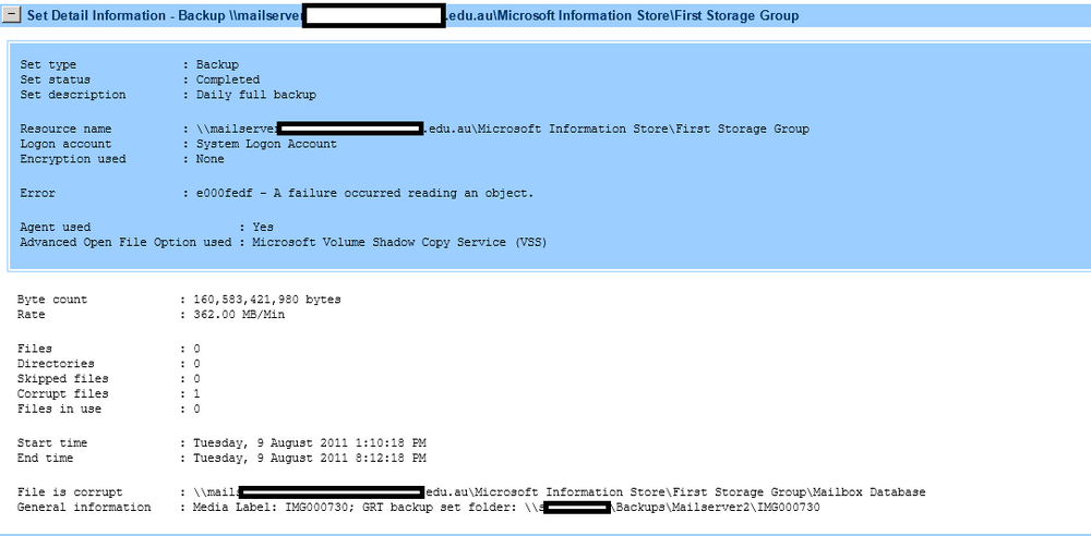

Exchange is working fine, but as of yesterdays backups for exchange, they have been failing with the following error:
Ive tried to re-run the backup but it fails at different points (im looking at the amount of data it copied and it was different on both when it failed)
Not entirely sure what or where I should look or if this is a bexec issue or there is actually corruption in my data store.

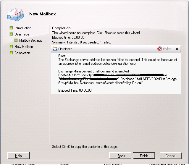

However, there seems to be a big issue with Exchange now, as I cannot create any new accounts. Please see attached. I am going to restart the server in a couple of hours, so hopefully that will fix the issue but will see.
