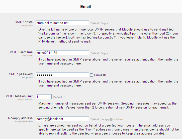

Hallo there
I have been trying to find out how to set my email in Moodle 2. I am new to Moodle I like it very much and how you can make the quizzes and courses.
My problem is when a student creates account it says message failed.
Under Server and email I have set it like this.
smtp hosts: smtp.dsl.telkomsa.net
username: online2212355
Password: for email: ******
Everytime I create account for a new user pretending to be student to test the email it says message failed cannot send.
Why is this?
Thank you

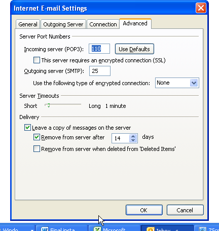

1. The 1st & 2nd picture is of Outlook.
2. The 3rd seems to be of moodle.
3. smtp.dsl.telkomsa.net - Is this a windows server with SMTP service running? IS it an exch server? Is it a unix server?
4. Is smtp.dsl.telkomsa.net working from other applications or for Outlook if it's used for this.
5. I got no idea what smtp.dsl.telkomsa.net this is so I cant say where to look for logs, if you reply to point3 I may be able to help.

Hallo there
The system I am using is windows xp sp2. The email works fine in microsoft outlook I do not use microsoft exchange. With these email settings I sent you.
I sent you a screenshot of moodle to show you what I had typed in there for...smtp which is also used for the outlook email, which is smtp.dsl.telkomsa.net
and my pop3 is pop3.telkomsa.net.
What must i put in moodle 2.03 for email to work or how should I go about it?
I am running moodle for windows as a localhost from pc. Yes it is the first time I am trying to set up moodle any help would be appreciated.
Thank you

I tried the telnet commands and this is a screenshot of what I got.
I also set Moodle to smtp.dsl.telkomsa.net
What else do I need to do.
I tried again to set up account pretending to be a student in Moodle on the login screen and itsaid
SMTP Error: Could not authenticate. ERROR: SMTP Error: Could not authenticate.
SMTP server error: 5.5.2 Error: command not recognized
Thank you
Cheryl
