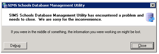

When a discover database is backed up manually using the dbAttach.exe GUI, the backup completes successfully.
Nightly though, we script a backup to take place using the dbAttach command parameters to back up SIMS and FMS through a batch file. This always works perfectly and I have modified the script to also backup the new Discover database. The command is exactly the same for the SIMS and FMS backup minus the database name:
"D:\Program Files\Microsoft SQL Server\MSSQL10.SIMS2008\MSSQL\Binn\ dbattach.exe" /BACKUP /AUTO /SERVER=%COMPUTERNAME%\SIMS2008 /DATABASE=Discover /USER=****** /PASSWORD=******
When running this through the command prompt, this pops up:
Has anyone else come across this? Is anyone else successfully backing up Discover this way?
Edit: tested on my local XP machine and I get the same issue. Defiantly some kind of problem with dbAttach.

All the parameters are 100% correct. Discover attaches itself to the SIMS2008 SQL instance. It says you can put it there in Capita's install guide. I tested it against my own test system and experienced the same issue.

@Rawns have you tried adding the /path?
Thanks Matt. :)
Just tried this and it seems to work. The only down side is that you have to specify a file name with the Path command so there will only ever be one backup as it will overwrite the previous one.
/path:"S:\MSSQL10.SIMS2008\MSSQL\Backup\discover_%date:~-4,4%%date:~-7,2%%date:~0,2%.bak"
