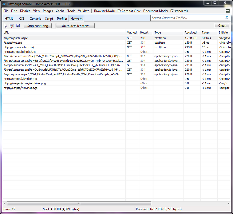

jamesfed Posted May 23, 2011 Posted May 23, 2011 (edited) Seem to be having some problems with getting HAP up and running Problem appears to be that some of the files that HAP are using are pointing to the wrong location (as you can see in Capture-3) - I believe (fingers crossed) that I've got everything configured right in the web.config file (attached with Passwords removed) and have followed the YouTube video as to how to setup HAP. I'm using v6.3 of HAP with IIS 7.5 on Server 2008 R2 and its a Vanilla network. Any clues as to where I should be looking would be grand Web.txt Edited May 23, 2011 by jamesfed
nickbro Posted May 23, 2011 Posted May 23, 2011 HAP+ doesn't like being run from the root, it needs to be in a folder 1
jamesfed Posted May 24, 2011 Author Posted May 24, 2011 Cheers - moved all the data into a sub folder and it works a treat. This is a truely great little program
