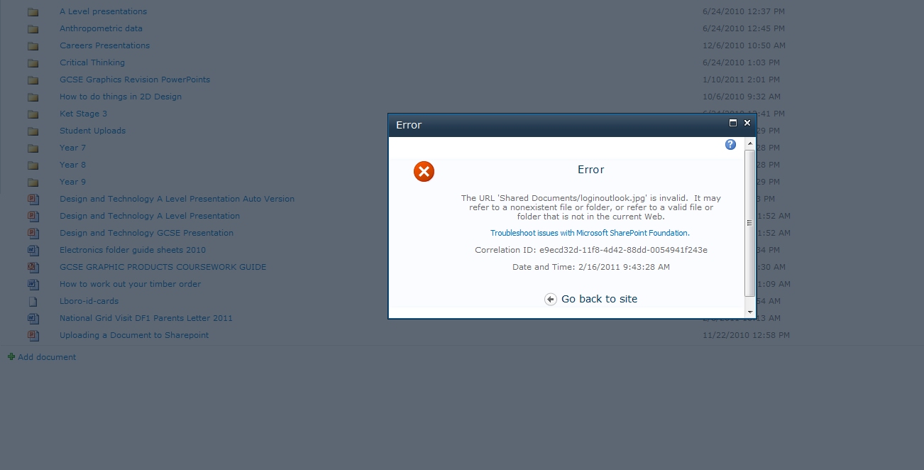

zag Posted February 16, 2011 Posted February 16, 2011 (edited) Came in this morning to find a few reports of things not working on Sharepoint 2010. Basically when I try to upload a document it says "The URL is invalid, it may reference a non existing file or folder" I've tried rebooting the sharepoint server but no luck Any ideas how to troubleshoot this? EDIT: Got it I think. SQL server is producing this error Log Name: Application Source: MSSQL$SHAREPOINT Date: 16/02/2011 09:43:28 CREATE DATABASE or ALTER DATABASE failed because the resulting cumulative database size would exceed your licensed limit of 4096 MB per database. Edited February 16, 2011 by zag

apearce Posted February 16, 2011 Posted February 16, 2011 you need to install full SQL Server as your limit to SQL Express is full. You can do this 2 ways 1. Export your SharePoint environment, don't forget to include security permissions and the import it into a completely new SharePoint farm. Export a site, list, or document library (SharePoint Server 2010) 2. Connect your SharePoint farm to a new SQL Server and remove the connection to the existing database. The connect SharePoint using database attached. If it was me - I would do option 3 3. Create new farm that is not standard install. Build the farm with just the service application you require and then do a database attached to the new farm. A. Came in this morning to find a few reports of things not working on Sharepoint 2010. Basically when I try to upload a document it says [ATTACH=CONFIG]9477[/ATTACH] "The URL is invalid, it may reference a non existing file or folder" I've tried rebooting the sharepoint server but no luck Any ideas how to troubleshoot this? EDIT: Got it I think. SQL server is producing this error 2
