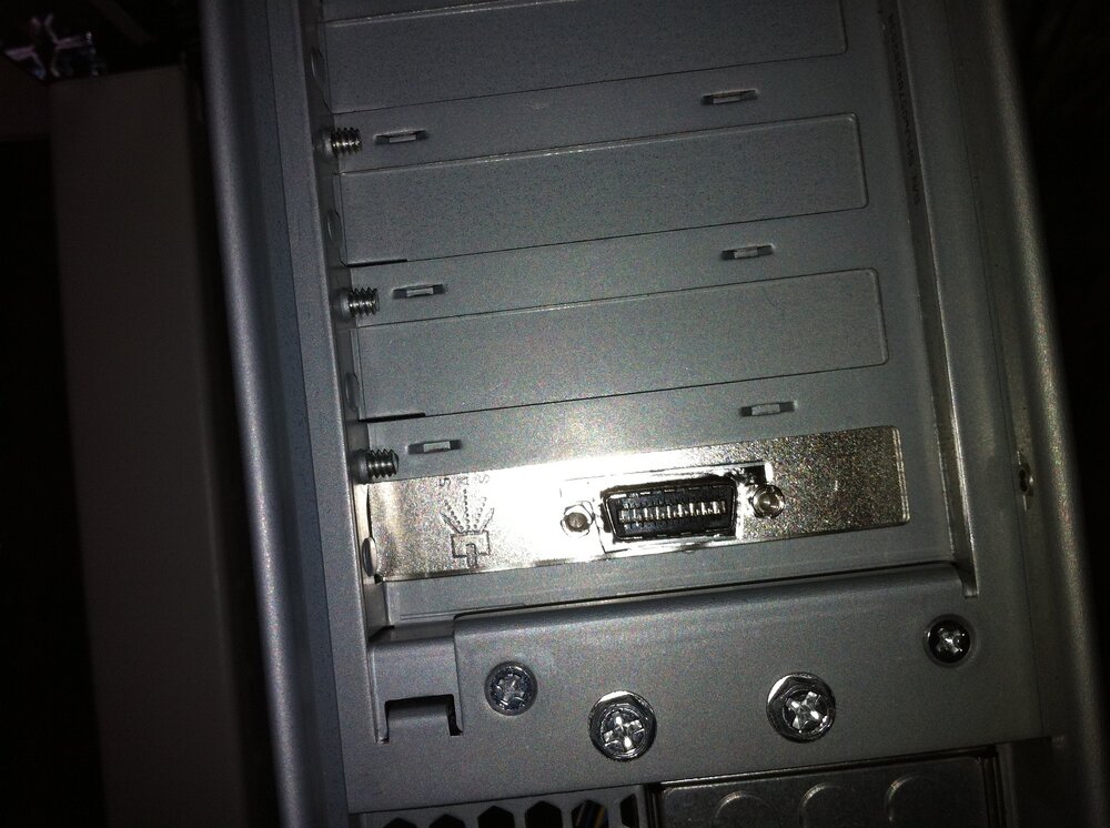

Can anyone shed any light on this port? It's on the back of the Intel storage box and I think it's an external SAS port but I'm not entirely sure. If it is, can I use that to connect back to the NEC server?
If not, what's the best way of physically connecting the servers to the SAN device?
Rich
Yes that does look to be a connector for external SAS enclosures. As the storage box is a server rather than a dedicated server device though it is not designed to work as an output. Even if it was it would only be able to connect with a single machine at a time.
You would need to use some software like mentioned above to expose the storage as iSCSI over the network ports. You would then use the iSCSI initiator as either a seporate download for 2003 or integrated into 2008 in order to subscribe to the storage offered by the server.
As for migration you could install your preffered VM host OS onto a seporate computer temporarily and install the newer server OS on that in a VM then perform the migration that way. Once its done you can simply reinstall the main server with your VM host OS and move the VM from the temporary box to the main server, if your storage is provided by iSCSI this make this step much easier and quicker.
